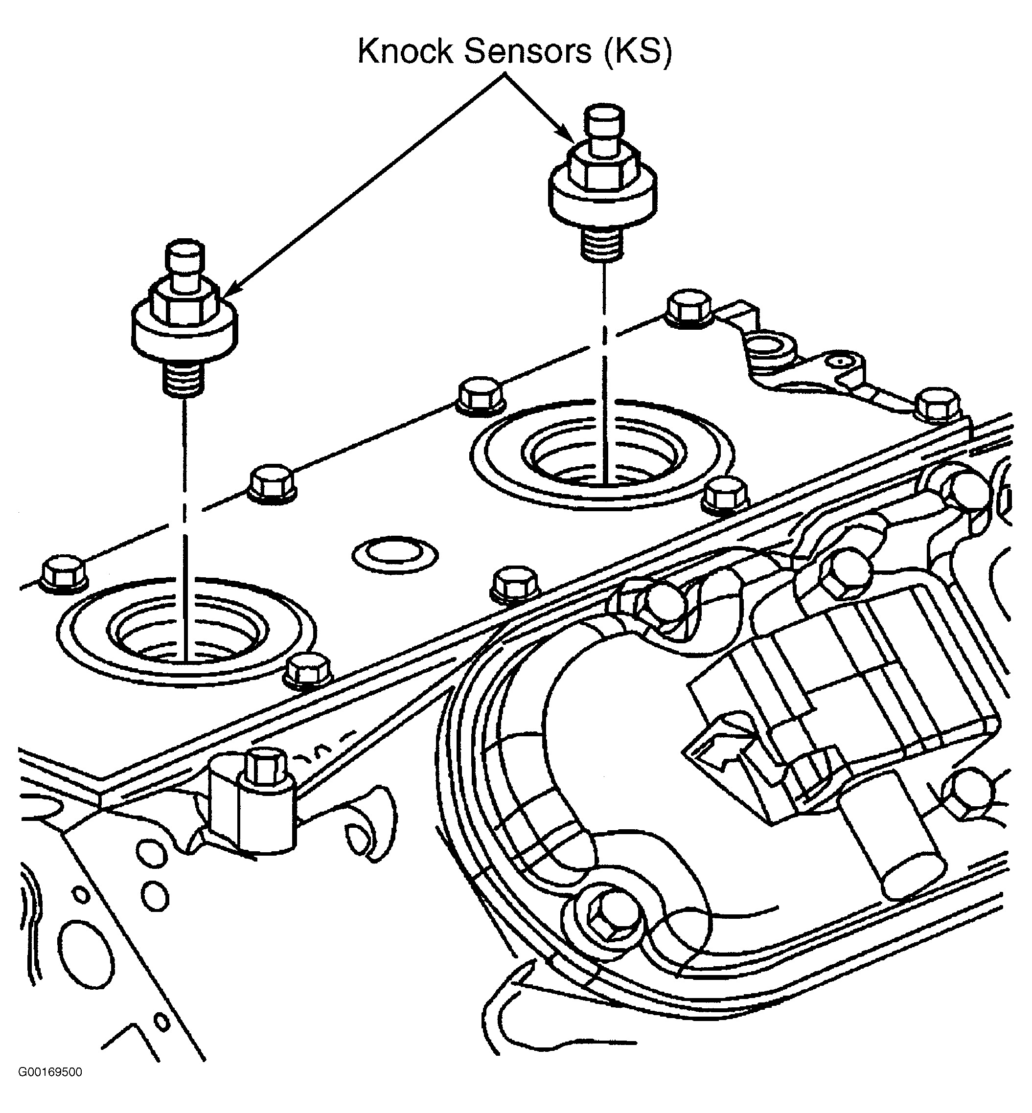

Need to know where the knock sensor is located

FOUND YOU A DIAGRAM IN "PRODEMAND"
SEE IT BELOW

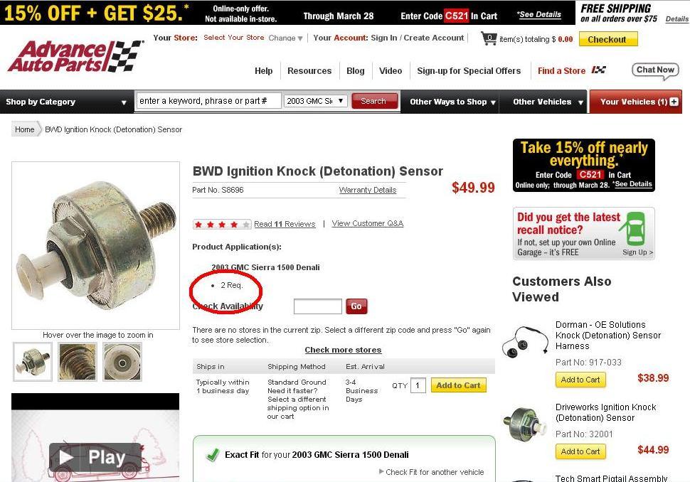

Are u sure? Auto zone says it's on the drivers side just in front of the oil filter and below plugs. They only sold me one. Not two. Thank you for tor answers.

I'M SURE THAT'S WHAT "PRODEMAND" SAID!
I WENT A STEP FURTHER
SEE MY PIC BELOW
THIS MIGHT SAVE YOU $10 THIS TIME
