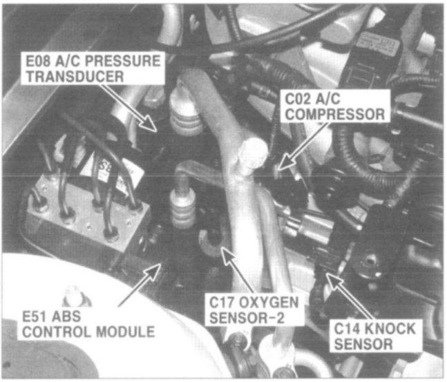

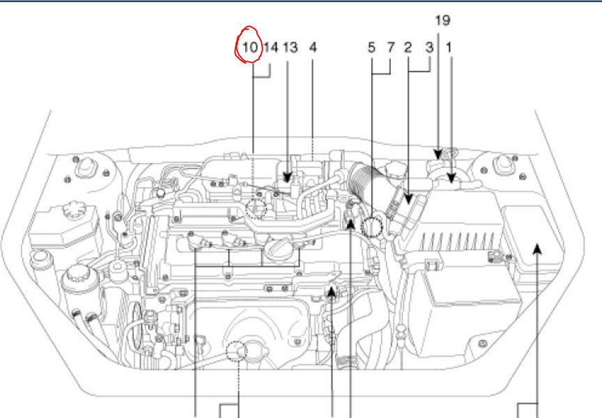

Where is the knock sensor located?
Thursday, November 14th, 2019 AT 9:15 AM
DANNY L
MECHANIC
5,648 POSTS
Hello, I'm Danny.
Here is a tutorial showing how a knock sensor works:
https://www.2carpros.com/articles/how-a-knock-sensor-works
Below I've attached 2 pictures showing its location as you requested.First picture location is #10 circled in red.Hope this helps and thanks for using 2CarPros.
