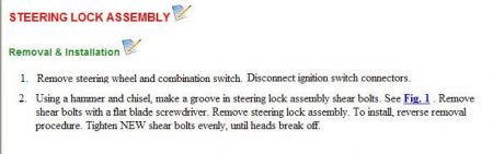

How do I remove the tunbler mechanism from the ignition to remove a broke key.
Wednesday, June 17th, 2009 AT 4:04 PM
BLUELIGHTNIN6
MECHANIC
16,542 POSTS

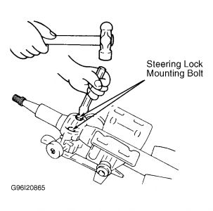

FIGURE 1
Wednesday, June 17th, 2009 AT 4:08 PM
