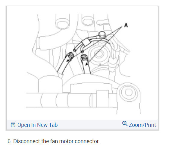

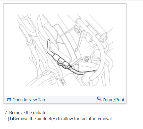

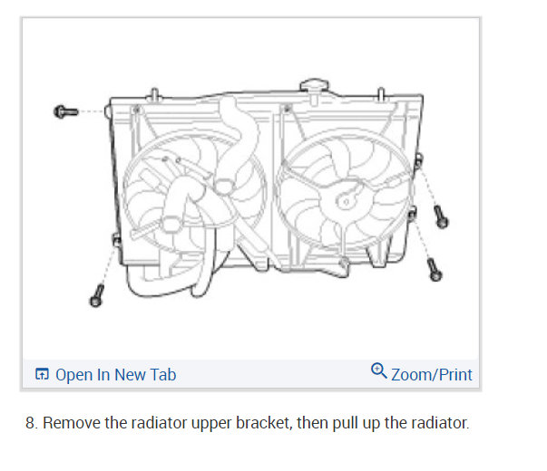

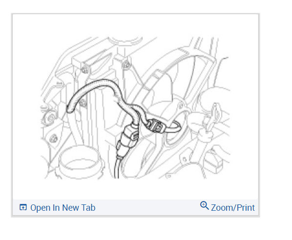

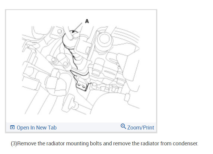

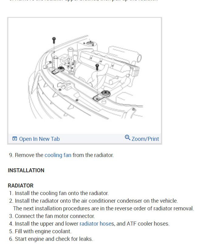

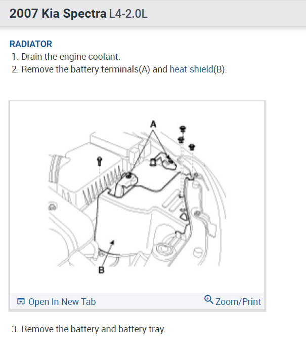

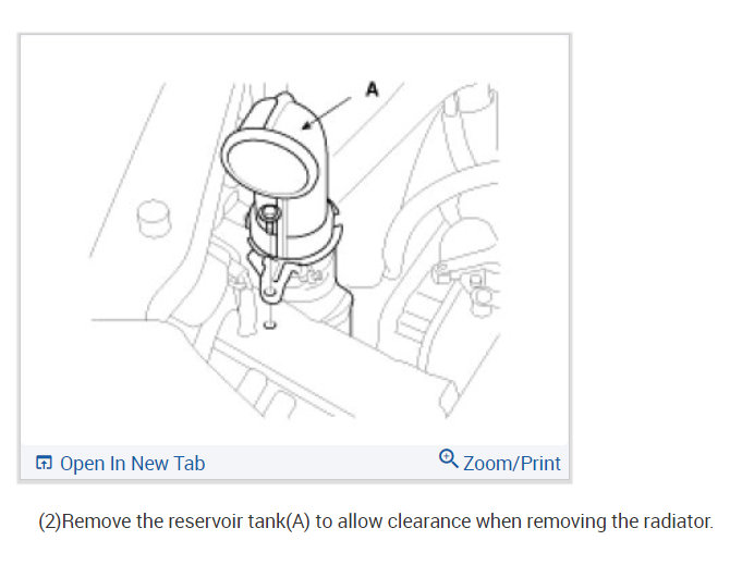

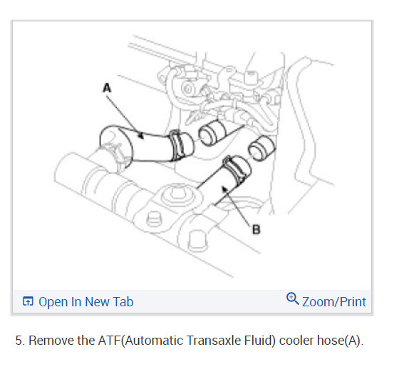

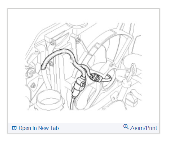

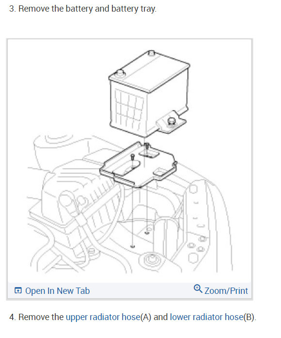

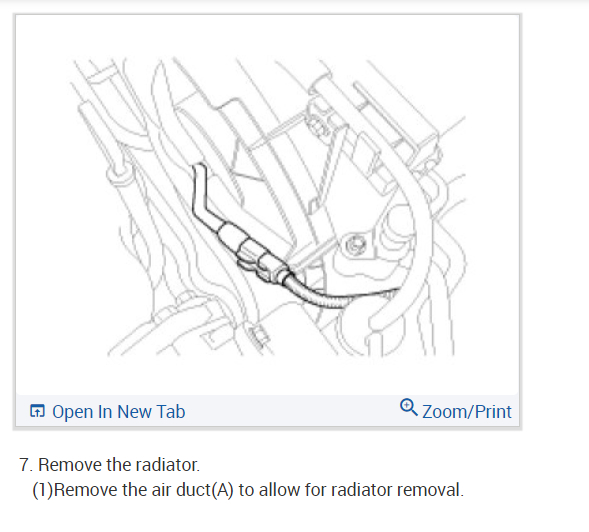

Here is a guide to help you step by step with instructions in the diagrams below to show you how on your car:
https://www.2carpros.com/articles/how-to-replace-a-car-radiator
Images (Click to make bigger)
