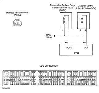

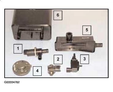

Where can a find the vent control valve circuit?

1 Canister Close Valve (CCV)
2 Fuel Tank Pressure Sensor (FTPS)
3 Canister Purge Valve
4 Fuel Cut Valve
5 CCV Air Filter (Sedona shown)
6 Charcoal Canister
