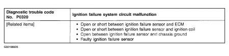

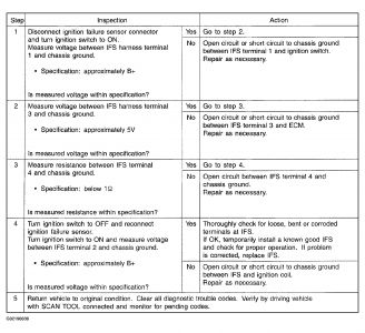

What is the test to perform to see if the ignition sensor is the problem?
Monday, November 1st, 2010 AT 2:33 PM
DOCFIXIT
MECHANIC
18,828 POSTS
Was code P0320? if yes preform these tests
