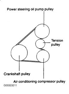

How do you change the powersteering belt

Power Steering & A/C Compressor
Loosen tension pulley adjustment bolt "A". See Fig. 5 .
NOTE:Belt tension must be measured between the specified pulleys. See deflection measuring positions in Fig. 1 .
Turn adjusting bolt "B" to set belt tension to specified deflection. See BELT ADJUSTMENT table.
Tighten tension pulley adjustment bolt "A" to specification. See TORQUE SPECIFICATIONS .
Recheck belt deflection after cranking engine over one or more revolutions and readjust as necessary.
NOTE:When a new belt is installed, adjust the tension to the central value of the standard range indicated for new belt deflection. Let the engine idle for 5 minutes or more, and check the standard value indicated for inspection. Readjust belt tension as necessary. When adjusting a belt which has been used or a belt newly installed after 5 minutes or more of operation, refer to the standard value indicated for used belt deflection. See BELT ADJUSTMENT table.
