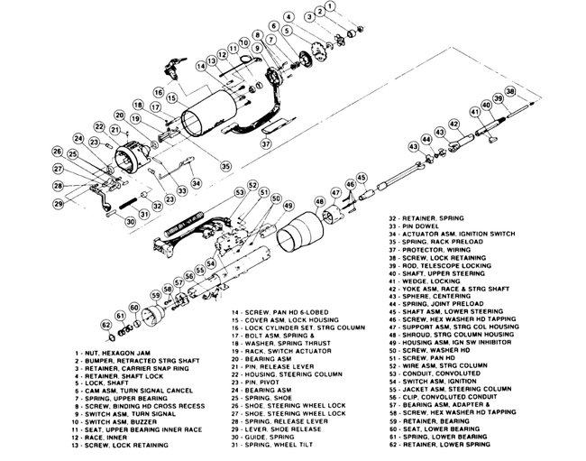

The key has a hole in it chip is missing. How much it cost to fix? And how do I go about fixing it? I think I need to replace the tumbler?
Thursday, September 28th, 2017 AT 7:51 PM
13 Replies
KEN L
  • MASTER CERTIFIED MECHANIC
  • 55,281 POSTS

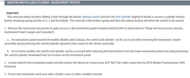

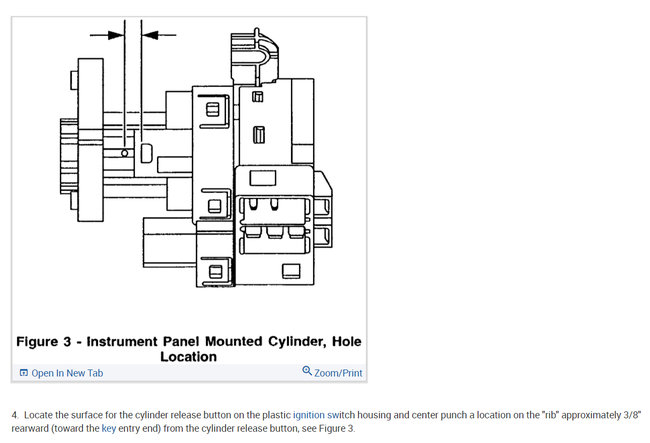

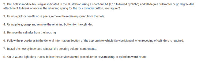

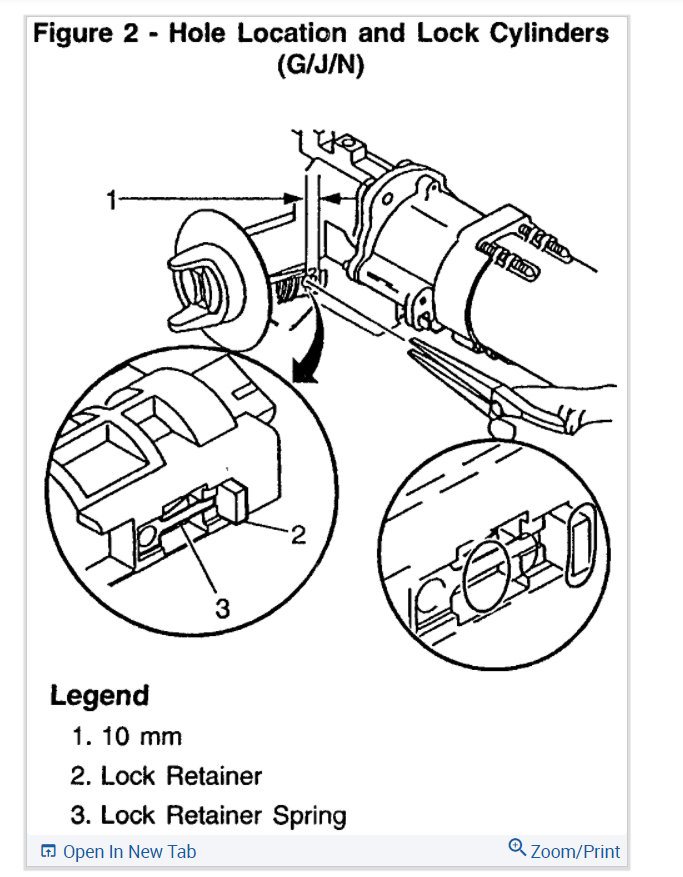

You will need to go to a shop or the dealer and the cost should be about $140.00 to have them make a key and program it for you then you can use these instructions to replace it. Check out the diagrams (Below). Please let us know if you need anything else to get the problem fixed.

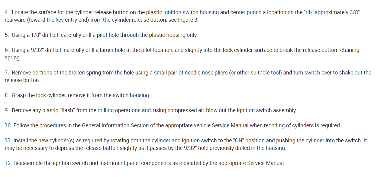

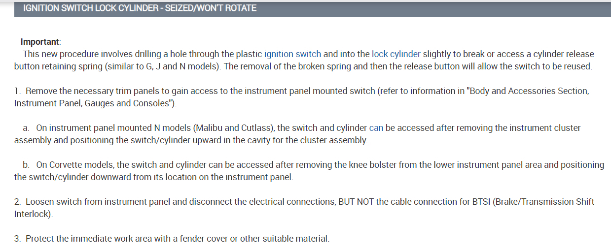

DONKKEY13
How would I just remove the lock where the key goes in the ignition cause the ignition will not turn to the off position so the car will shut off it is a 1989 Buick Riviera have 5 dollars for this issue

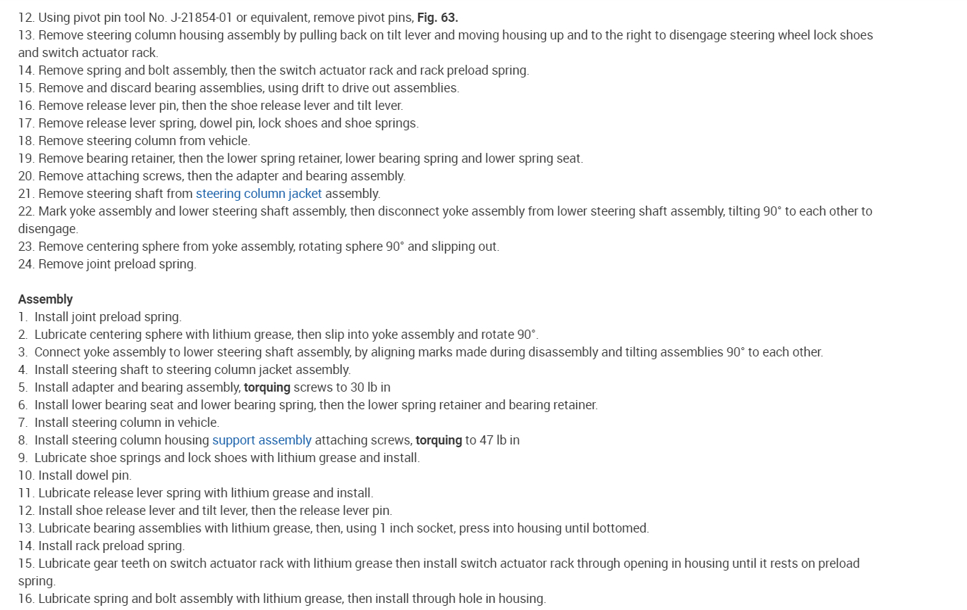

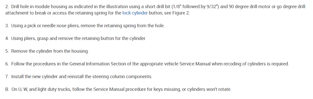

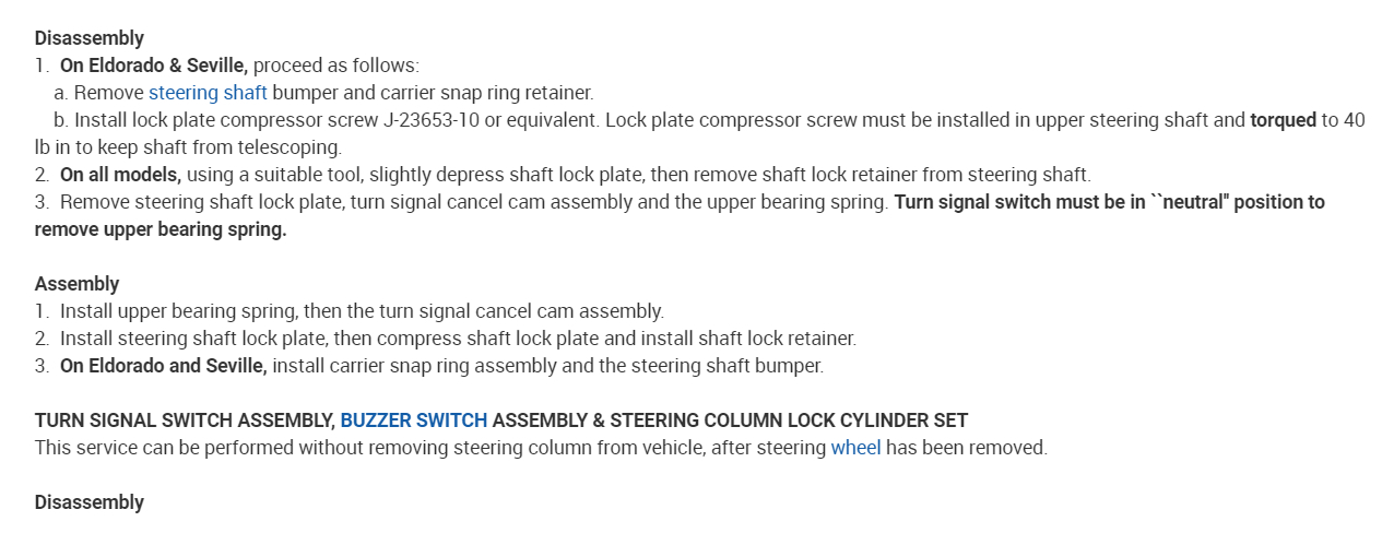

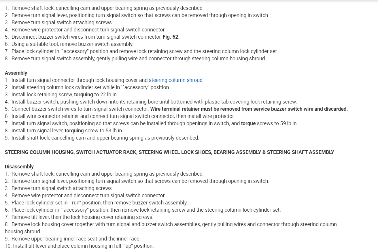

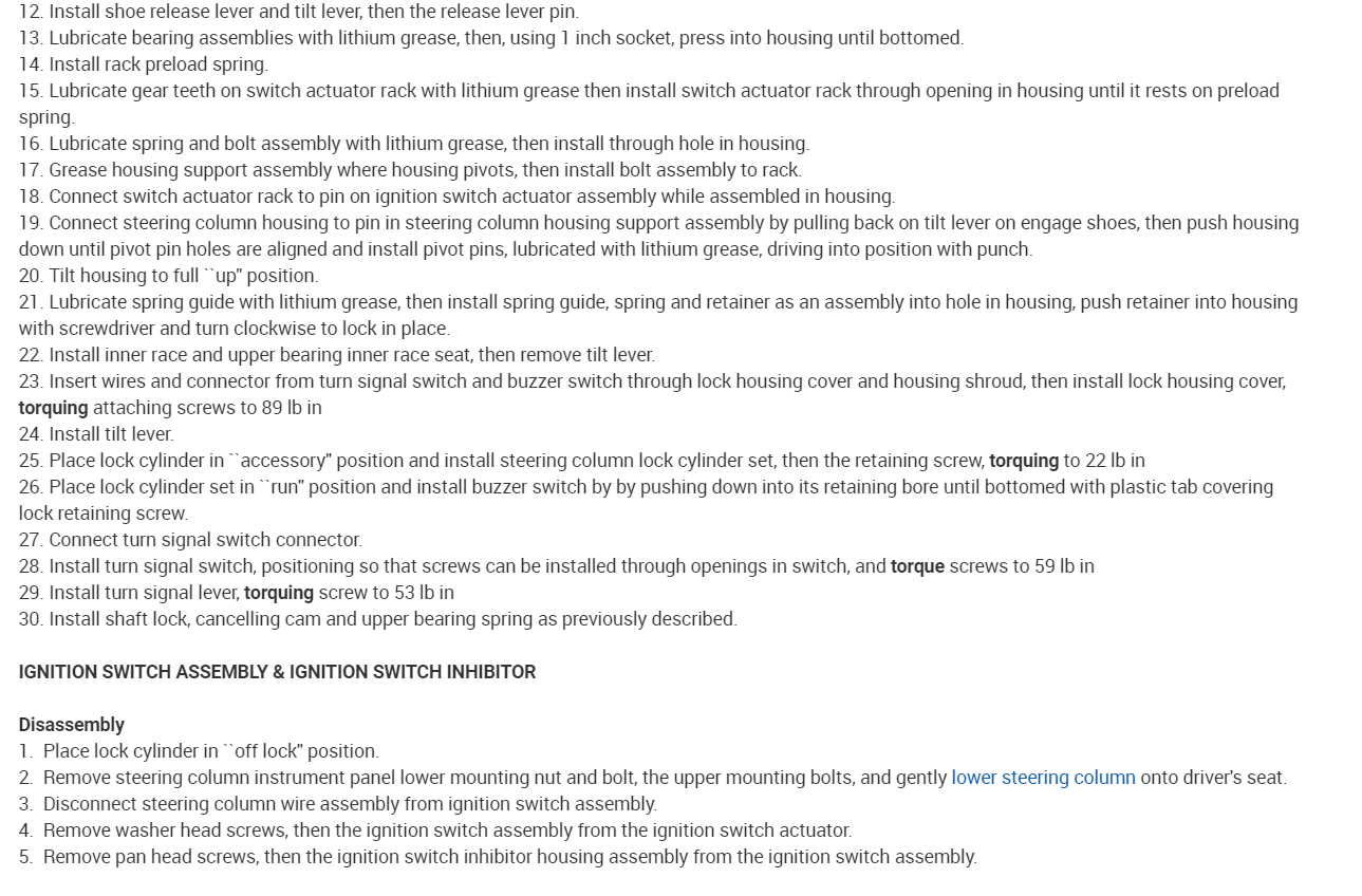

KEN L
  • 55,281 POSTS

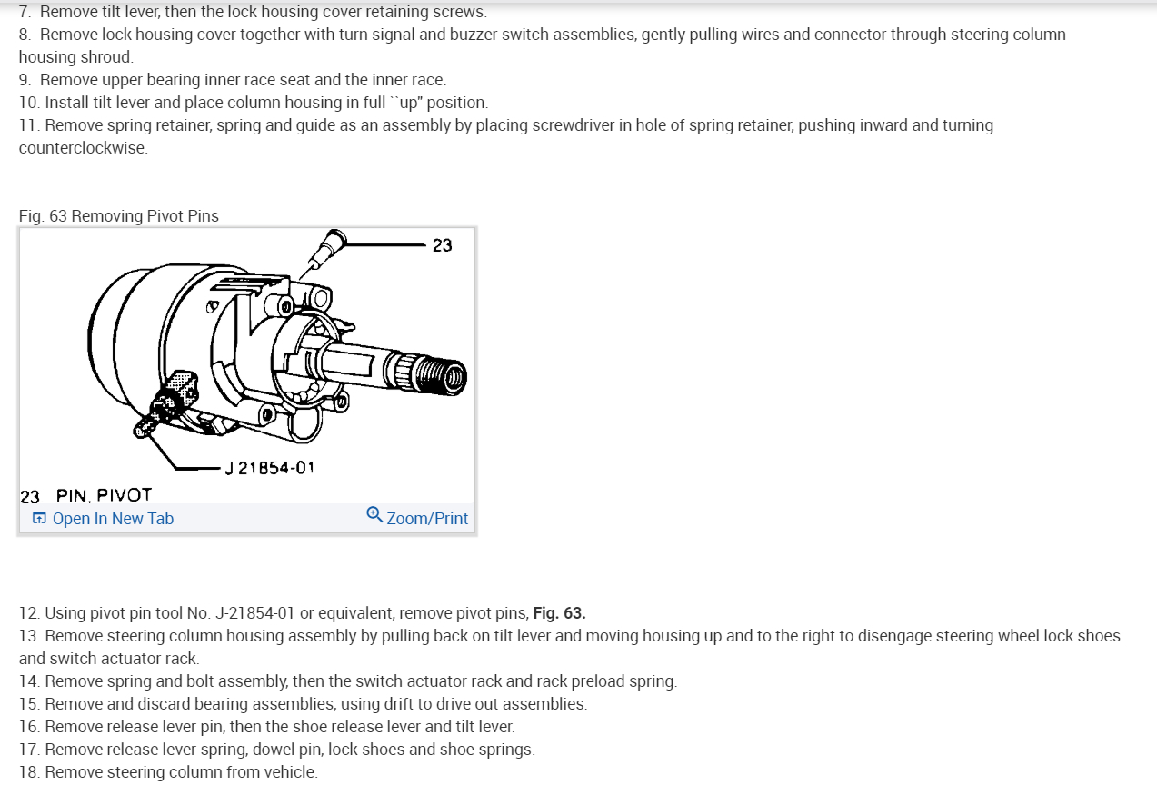

You will need a new lock and key here are the instructions on how to change the ignition lock and turn out. Check out the diagrams (Below). Please let us know if you need anything else to get the problem fixed.

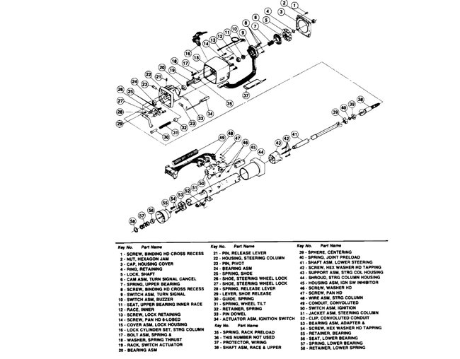

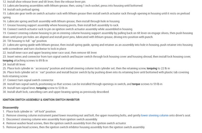

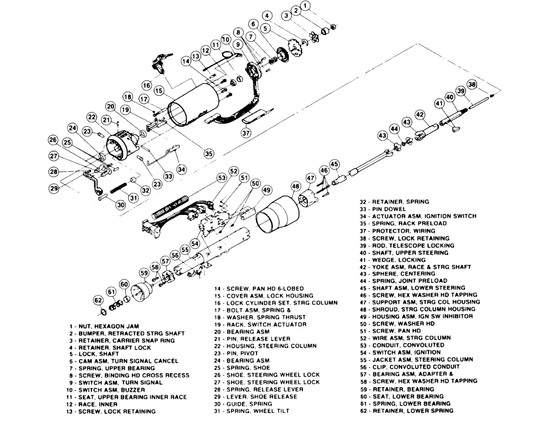

IAN CARPENTER

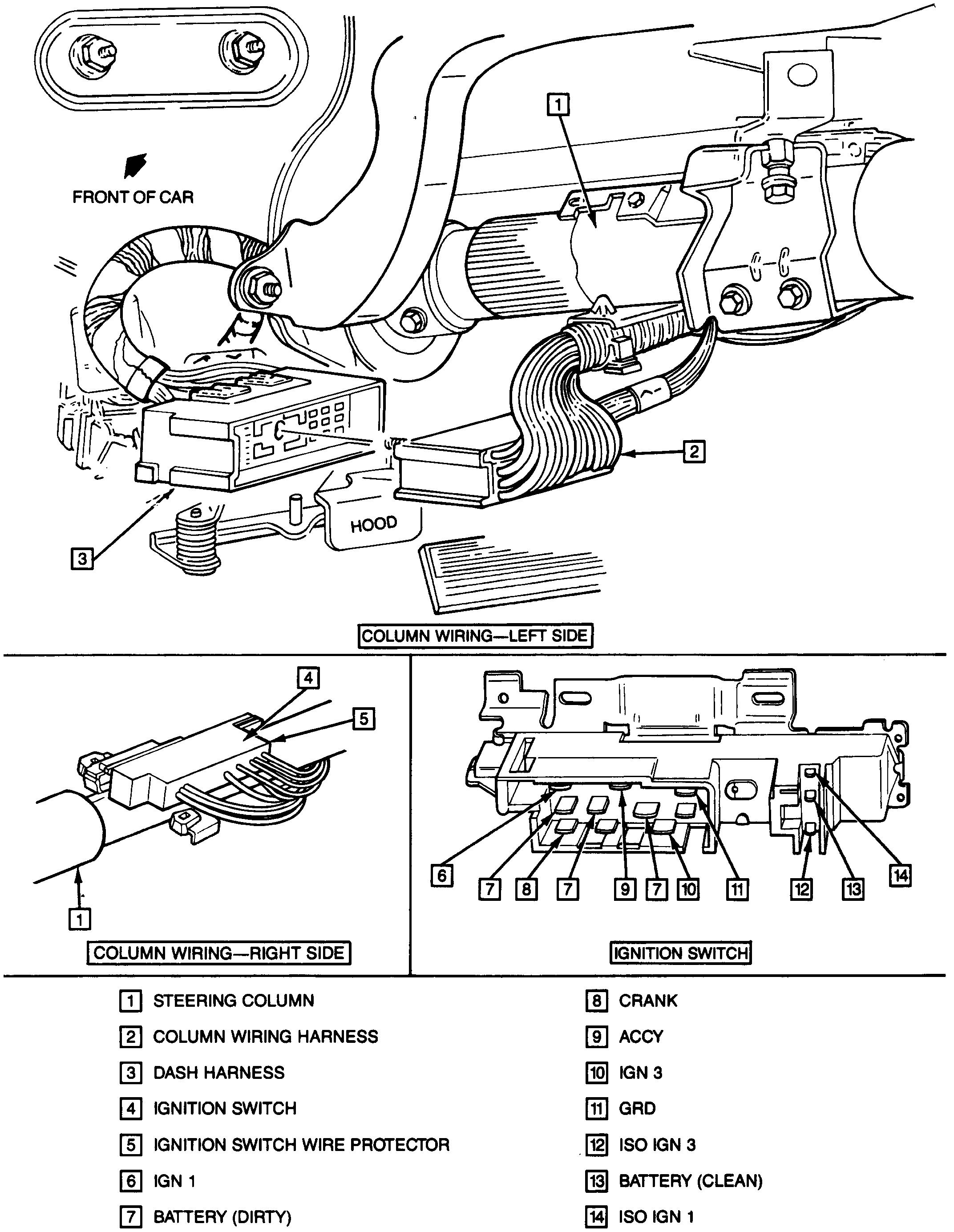

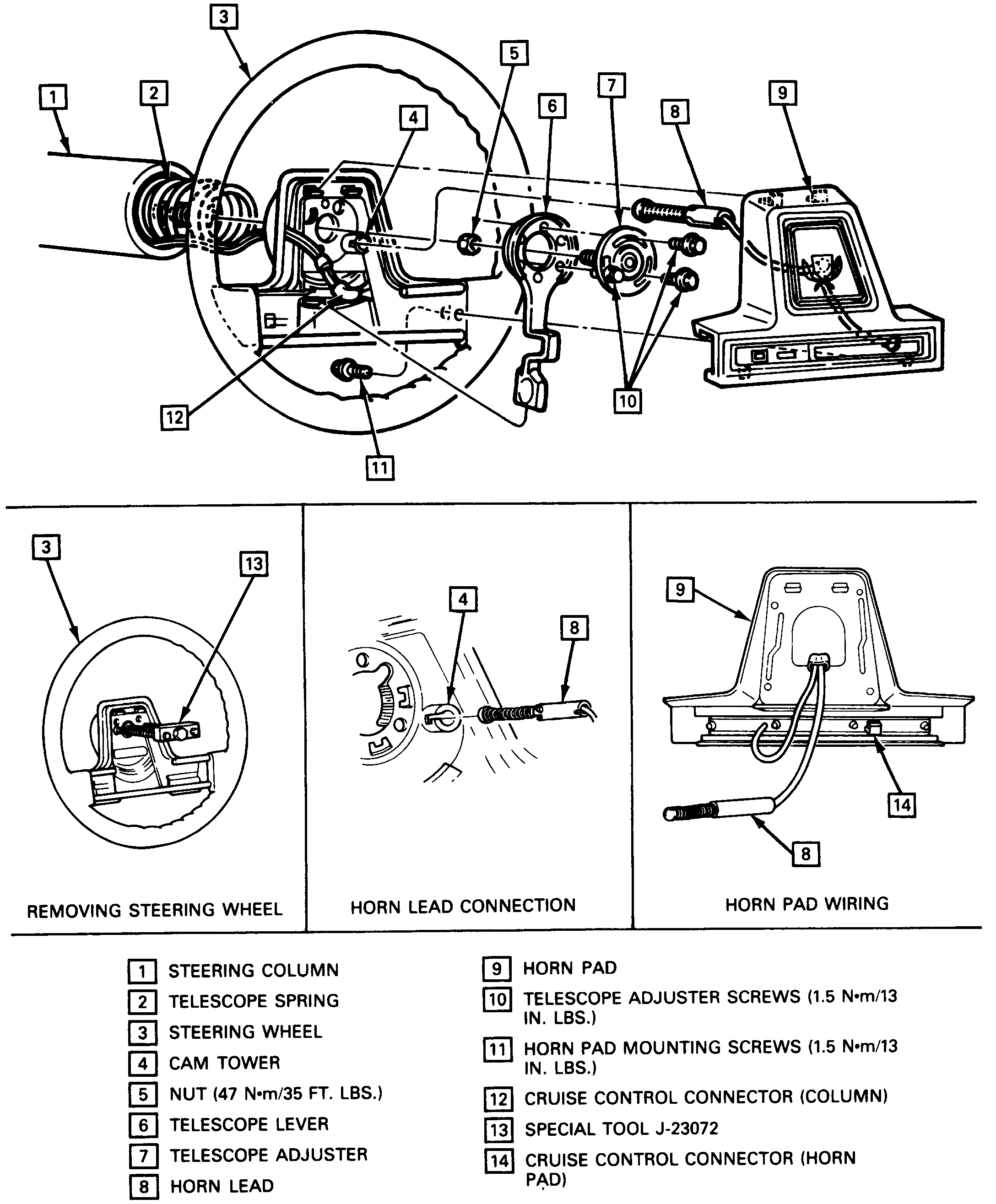

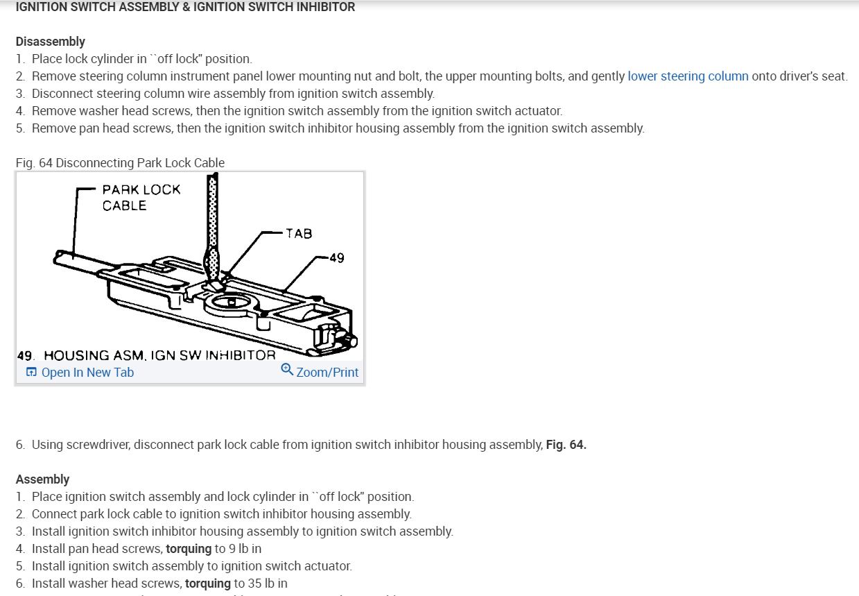

On 1989 Buick Riviera, Do I need to remove the steering wheel to replace the ignition tumbler/cylinder or is there a tool to remove it?
Wednesday, November 11th, 2020 AT 4:45 PM (Merged)
  • 110,192 POSTS
If you are replacing the switch and not the lock cylinder, here are the directions. Also, yes it needs removed.
1989 Buick Riviera V6-231 3.8L VIN C SFI
Ignition Switch
Vehicle Steering and Suspension Steering Steering Column Service and Repair Removal and Replacement Ignition Switch
IGNITION SWITCH
WARNING Before preforming this procedure, disarm airbag as outlined under Airbag Arming and Disarming. Failure to do so may result in accidental deployment of airbag, possibly causing personal injury.
Steering Wheel And Horn Pad
pic 1
Ignition Switches And Column Wiring
pic 2
REMOVE OR DISCONNECT
The ignition switch is hardwired. The wiring harness with the column harness connector must be replaced with the ignition switch. DO NOT splice the new switch to the existing column wiring harness.
1. Left hand sound insulator.
2. Instrument panel steering column cover.
3. Ignition switch wire protector.
4. Screws holding switch to column.
5. Ignition and turn signal switch column harness connectors from dash connector.
6. Turn signal switch harness connector from column harness connector.
7. Ignition switch assembly, including switch, harness, and connector.
INSTALL OR CONNECT
1. Ignition switch.
2. Screws holding switch to column.
3. Turn signal switch harness connector to ignition switch connector.
4. Ignition and turn signal switch harness connectors to dash connector.
5. Ignition switch wire protector.
6. Instrument panel steering column cover.
7. Left hand sound insulator.
