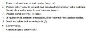

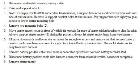

Can I rebuild my current starter, and how do I replace it

You can rebuild it depending on what has failed in it, yes. Replacement procedures are as follows:
REMOVAL:
INSTALLATION:
