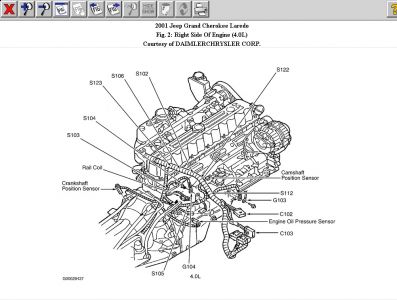

I have a 2001 Jeep Grand Cherokee Laredo and it is cutting out and dying when going down the road. The crank sensor is bad and I need to know where it is located on the motor? Thank You
