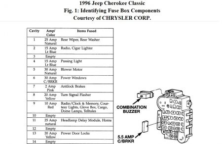

My driver side window and door lock panel does not work. I took it to a mechanic and he explained that it was a part that neede to be replaced. At the time all other windows adn door locks worked fine. I got the car back and now none of the windows or door locks work. Thought it might be a fuse that had blown but in the owners manual I found no fuse description for power windows or power door locks. Am I missing it?

I guess I don't understand? Did you ask the mechanic why it won't work? Did he replace the part? As far as the power windows, there is a lock-out switch at the driver door control panel. If that switch is activated, the other windows can't be operated except at the driver control panel. There is a circuit breaker for the power windows in the fuse box. That circuit goes hot when you turn on the key. There is also a fuse for the door lock circuits. I didn't think to look for a lock out switch for the door locks?? The info I looked at was for cherokee classic fuse box.
https://www.2carpros.com/forum/automotive_pictures/512072_cherokee_classic_fuse_box_1.jpg
