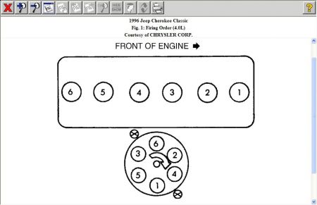

I am replaceing the spark plugs and wires I can not figure out the firing order

Here you go. Check out the diagrams (Below). Please let us know if you need anything else to get the problem fixed.
