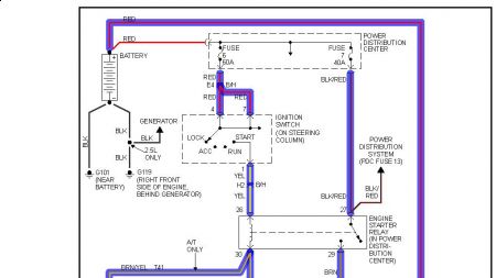

I have a 1995 Jeep Grand Cherokee and last week I turned the engine off and 2 minutes later it wouldn't crank. I tried to jump it off with the same results. Nadda. I pulled all the fuses to check and they were all good. After reinserting all the fuses it started, I think that was just coincidence. Three days later it's doing the same thing. The engine will not turn over at all. Tried starting in neutural with same results. Tried shifting through all gears and rolling just a foot or so then putting it in gear to see if that would help but it doesn't. Any suggestions?

Check fuse no.6 and no.7 if okay test the starter relay and park/neutral position switch.
Have helper hold key in start position and check for power at the brown wire on the starter solenoid-no power there its one of the above that's causing it-Power present its the starter.

I'm talking about the brown small wire at the starter solenoid it should have power when key at start position-
To check the N/P switch disconnect the wiring connector and use a jumper wire if the starter engages the engine the N/P switch is defective. Now if it doesn't crank over test the ignition switch. The starter relay is okay if it cranks over when you jump the P/N switch
