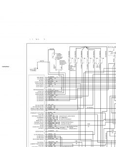

Dear sir,
I was having some problems in my automatic transmission, so I changed it with another used transmission box, after that I found the check engine lamp gets always on, and giving me codes 42 and 27, I did nothing with my engine or the injectors.
how to deal with such problem?

Code 42 :
condition is open or shorted condition detected in auto shutdown relay circuit (ASD )
so you need to check wiring and fuses
code 27 injectors circuit does not respond properly to PCM
again you have a wiring issue and need to check wiring harness
does it start
if no start: check and or replace crank sensor

I went downstairs to see what to do according to your advice, I found the cable of injector number 5 outside its soket, I returned it to its place and the "check engine lamp" went off.
Thanks sir for your valuable advice and your kind help.

You need to check the wiring
check the fuses
check the wires
you have a broken wire
https://www.2carpros.com/forum/automotive_pictures/99387_jeep95_1.jpg
Saturday, June 7th, 2008 AT 10:30 PM
