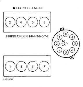

diagram on how to put my spark plug wires on
1994 JEEP CHEROKEE
120 MILES • V8 • 4WD • AUTOMATIC
RODWIGGINS
  • 10 POSTS
can u please send me a good diagram on how to put my spark plug wires on correctly i was changing them an some how cross tjhem up so please send me a giagram on which wire goes where

Hello - I was going to assist carlife65 as he may not have been able to pull up the diagram due to technical difficulties. I wasn't sure if your model was the Country, SE, Sport or Grand Laredo, Limited or SE and I am taking a chance that your engine size is a 5.2L. We hope this helps. If you provide me with more exact info above on your vehicle I can review to see if you have any recalls.
https://images.2carpros.com/forum/automotive_pictures/248015_Fire_order_1.jpg
