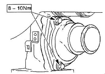

How do I install a new thermostat on this car, I bought it new from the dealer

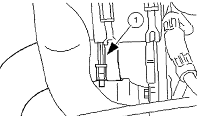

Disconnect the radiator bottom hose from the thermostat cover. Release and reposition the hose clip, and disconnect the bottom hose from the thermostat cover.
https://www.2carpros.com/forum/automotive_pictures/12900_c2_3.gif
Remove the thermostat cover. Remove the three bolts, which secure the thermostat cover to the housing. Remove the thermostat cover from the housing.
https://www.2carpros.com/forum/automotive_pictures/12900_c3_2.gif
Remove the thermostat from the housing. Remove the thermostat from the housing. Remove (and discard) the seal from the thermostat. Fit a new seal to the thermostat. The seal may be fitted either way round.
Installation
Installation is the reverse of the removal procedure.
Fit the thermostat so that the vent ball valve locates in the recess in the cover.
https://www.2carpros.com/forum/automotive_pictures/12900_c4_3.gif
Tighten the thermostat cover bolts to 8-10 Nm .
Refill the cooling system.
