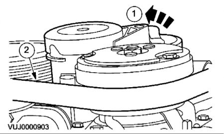

2004 Jaguar S-Type 6 cyl Two Wheel Drive
diagram on how to fit drive belt

Accessory Drive Belt 2.5L/3.0L
Removal
1.Disconnect the battery ground cable.
2.Remove the air deflector.
https://www.2carpros.com/forum/automotive_pictures/12900_db_4.jpg
3.Remove the accessory drive belt.
1.Rotate the accessory drive belt tensioner counter-clockwise.
**Use a 3/8 inch square drive bar to rotate the accessory drive belt tensioner.
2.Remove the accessory drive belt.
Installation
1.To install, reverse the removal procedure.
