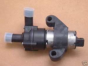

Ok I checked the heater control valve. What is the module located just above it? Once I unplug that one my heat came on (not the heater control valve)

Im not sure what it is called but it also has two hoses attached to it and a electrical plug in on top, that is the plug that I unpluged to make the heat work. What is that module called? Its pretty much right beside the ac condensor.

The one you unplug might be your Expansion valve manifold and tube and cap ports.
There is no diagram about the module you mention beside the condenser.
If you can trace any wire from the part you mentioned to a well known part. Then that can help.

Ill do one better and take a picture of it for you later today.

Here is a picture of the part i unpluged (Heater Circulation Auxillary Pump I think??) and warmer air started coming out.
