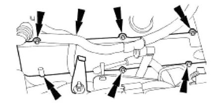

How do you change Spark plugs on Drivers side of a Jaguar S type,do you have to remove manifold.

Right-Hand Bank Remove the air intake tube. For additional information, refer to AIR CLEANER OUTLET PIPE . Left and Right-Hand Bank NOTE:Left-hand bank shown, right-hand similar. Fig. 14: Removing Ignition Coil Cover Courtesy of JAGUAR CARS, INC.
https://images.2carpros.com/forum/automotive_pictures/266999_jag_12.jpg
Remove the ignition coil cover. Disconnect the ignition coil electrical connector. Remove the ignition coil. Remove the spark plug
