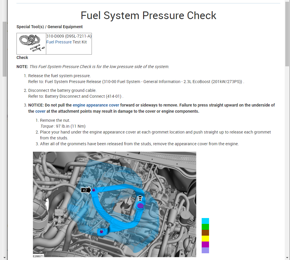

I've got P0089 fault fuel pressure performance. the car is lack of power when running and going to limp mode. what could the problem? please help me to fix thanks.
Jul 10, 2021 at 9:08 PM

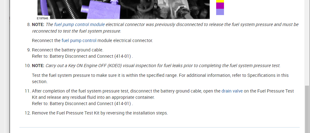

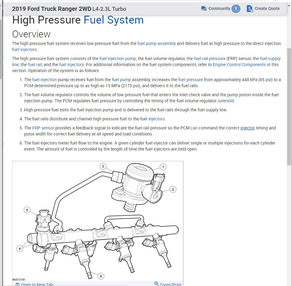

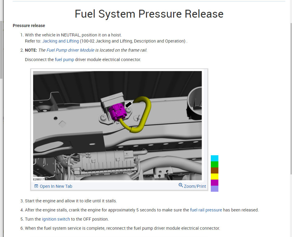

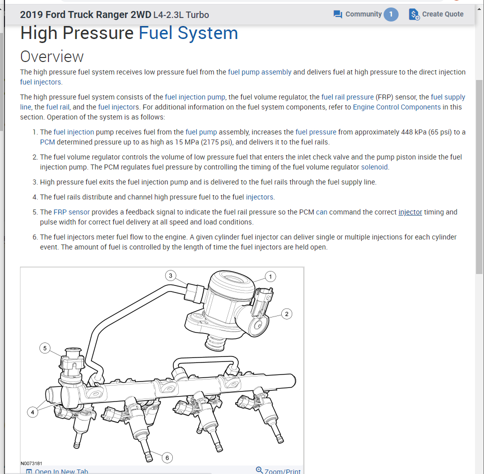

More than likely you have an issue with the high pressure fuel volume regulator. Basically this controls the amount of fuel that is used by the high pressure side of your engine.
I attached the info below on this sensor but here are a few guides that will help with this issue. As you will see, fuel is mentioned in these and so we are going to have to find out why you are loosing fuel pressure and setting this code.
https://www.2carpros.com/articles/symptoms-of-low-engine-power
https://youtu.be/U1RoG3I-Oww

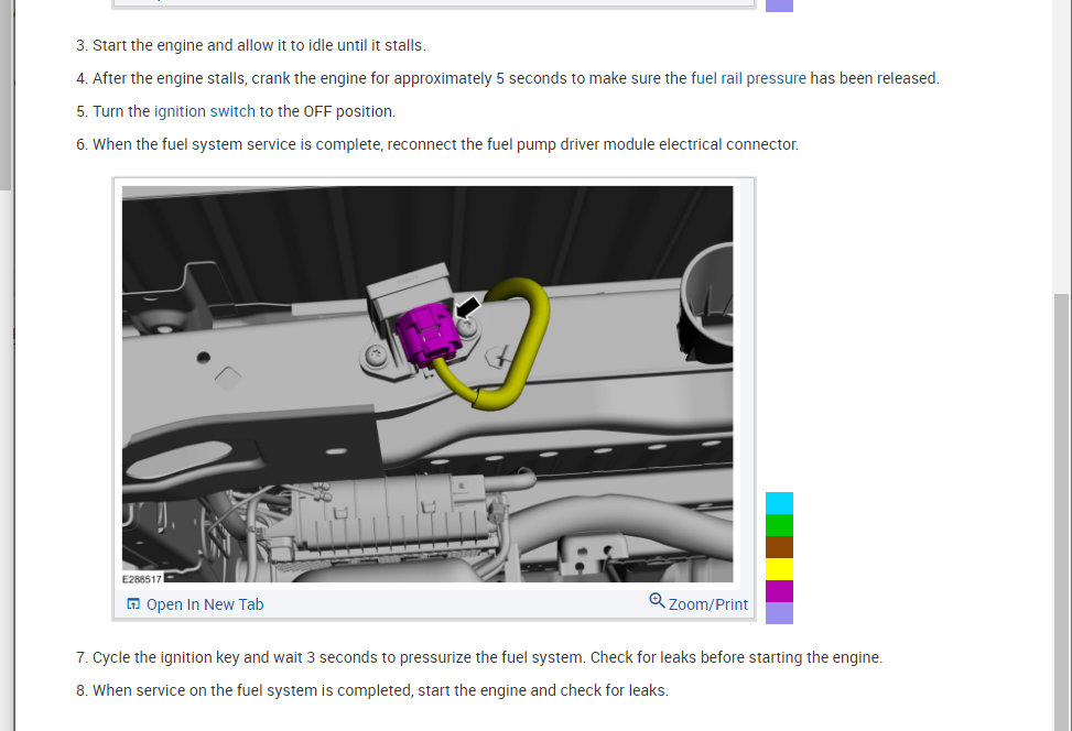

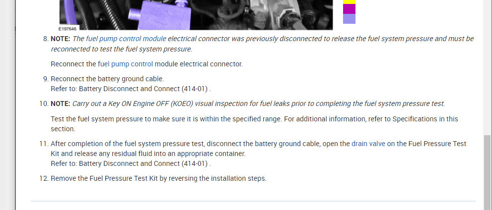

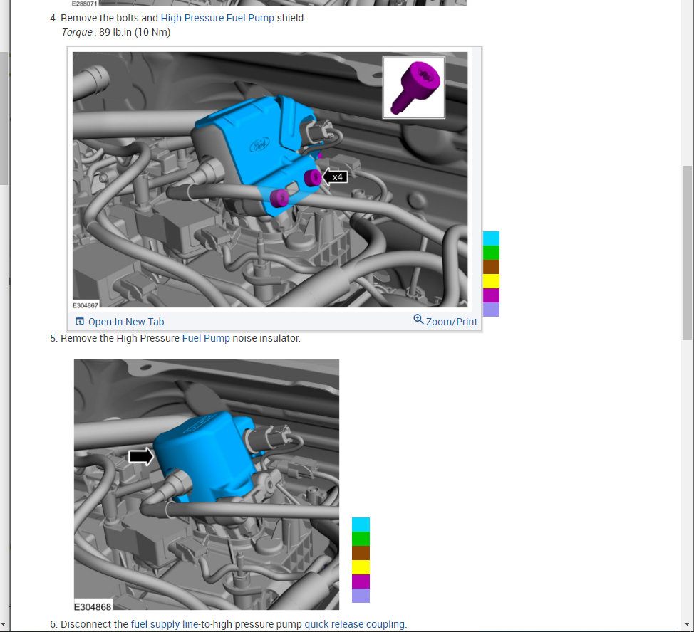

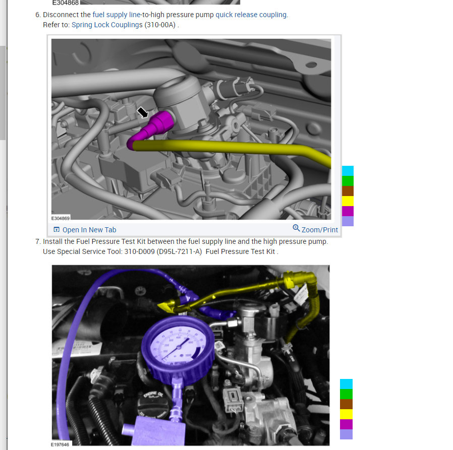

In order to find this we are going to have to start with checking the fuel pressure and that process is below as well.
Please let us know what you find with this and we can go from there. Thanks
