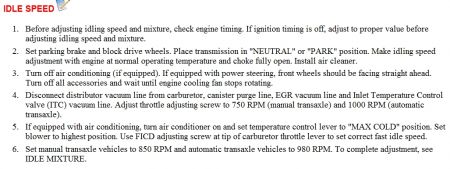

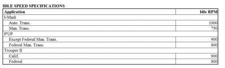

where is the idle adjustment located, how do I adjust the idle
