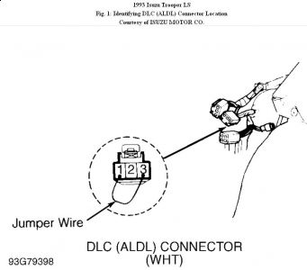

3. To retrieve codes, install a jumper wire between DLC terminals "1" and "3". DLC is a White connector located on right side of left foot well, ( some are located behind left of kickpanel). See Fig. 1.
https://www.2carpros.com/forum/automotive_pictures/192750_DLC93TrooperFig01_1.jpg

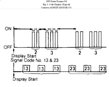

4. Turn ignition on and count number of flashes from MIL to identify codes. See Fig. 2. Each code will be flashed 3 times starting with lowest code number.
5. If system is operating properly (with no trouble codes present), Code 12 should be displayed with ignition on and engine off. This indicates diagnostic system is capable of storing codes and providing diagnostic information.
6. Once all codes are displayed, cycle will repeat. Remove jumper wire from DLC after codes have been retrieved.
https://www.2carpros.com/forum/automotive_pictures/192750_DLC93TrooperFig02_1.jpg

Unfurtunely I thoght this would happen, I cant find it on the left fender wall, nor on the left or right kick plate. Nothing that looks like your diagram, no lose outlet that looks like a plug to get a reading. Any suggestions were else to look.

In reference to the suggestion that I cant find the MLI plug, could it be a little black box thats 1/2 inch by 2 inches screw to the left fender wall? There is also another one on the right side in the same place. If it is how do you open it, it has some words on like MC-JA-.

It is a 3 pin socket plug and if it is not found on right of left foot well, then it should be on the left of right kickpanel.
Sometimes the socket is hidden behind the main wire harness or taped to it. Did you check the right of footwell, near the center console?
The black boxes are not the diagnostic terminals.

In reference to the diag. I finally found the plug and it gave me a code of the EGR valve, however, the problem continues it backs fire and and very rought, I have notice when I pull the wire of #3 cylinder the car continues to run with any diffrences in other words I have spark at the coil and at the spark plug, but if I remove the wire from the coil the car runs the same, like if the cylinder #3 is not working and I have good pressure at the cylinder? Please help
