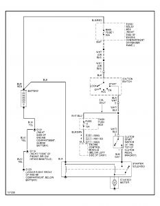

My 93 Isuzu Rodeo will not start or even crank (nothing) maybe a small clunk in starter. The battery is good. I removed starter (replaced before). Bench tested bad amped out, gravelly sound. Still no crank. I know I have constant 12V at starter (bat.) Not getting voltage ignition line. I have checked panel fuses and under hood relays and fuses. I tried to adjust clutch switch, but just dont see a clutch switch and book is no help. I have and can use a meter. Where do I check now? Does this seem ignition, timing belt, sensors? This problem was kind of sudden but I did notice kind of an "airy" whoosh at some starts prior. Since it is manual, will it tell me anything if I "push" start (or if it fails to start on push start). Please help>

There is a clutch sitch at the top of the clutch pedal bracket.should have a white/blue wire in from ign switch and a black/white out to starter.Be sure you have 12 volts in and out when clutch is depressed.
https://www.2carpros.com/forum/automotive_pictures/1639_Graphic_11.jpg
