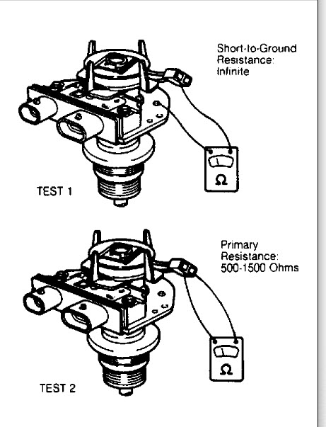

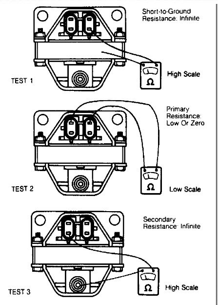

Injector pulse not working.
Wednesday, November 23rd, 2016 AT 12:45 AM
HMAC300
MECHANIC
48,601 POSTS

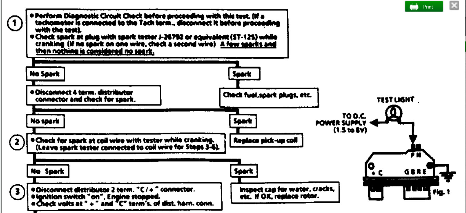

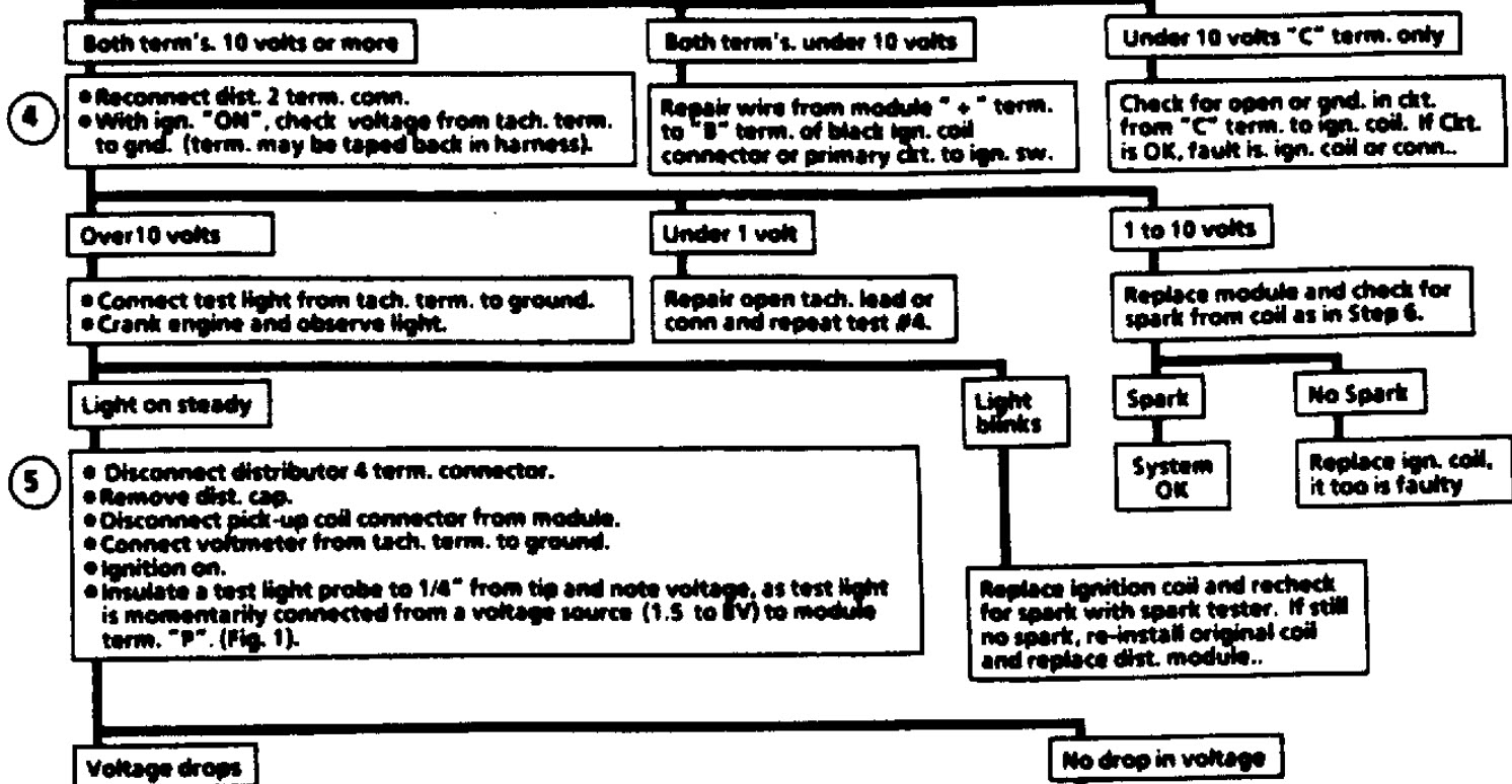

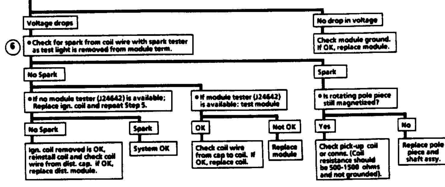

Scan for codes first see if you have spark, disconnect tachometer lead see if it starts first. See pictures.
