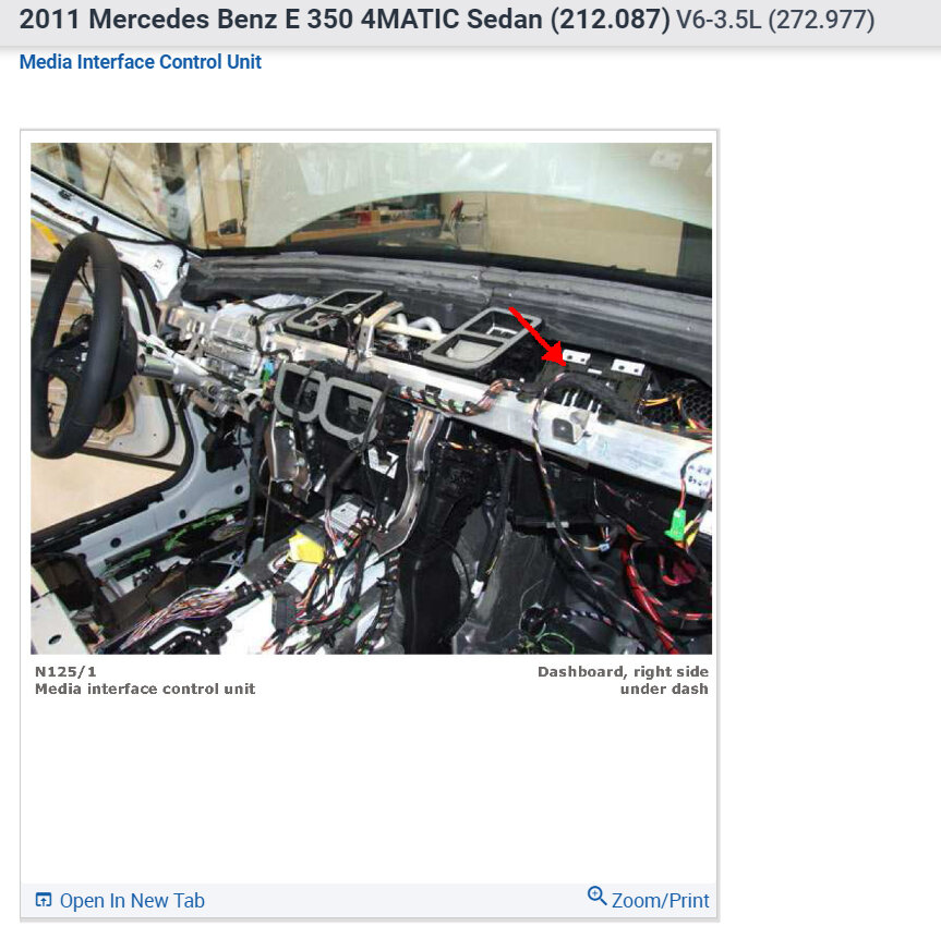

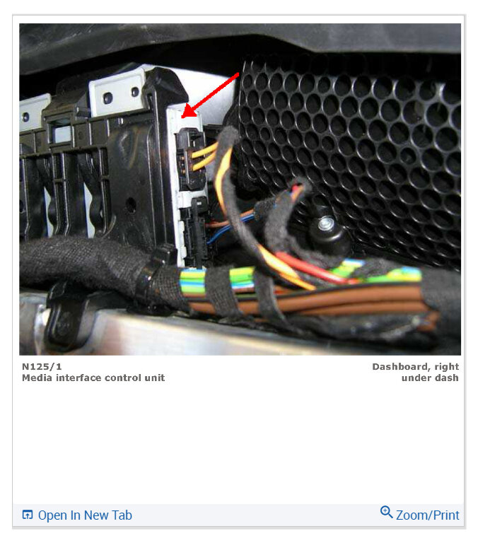

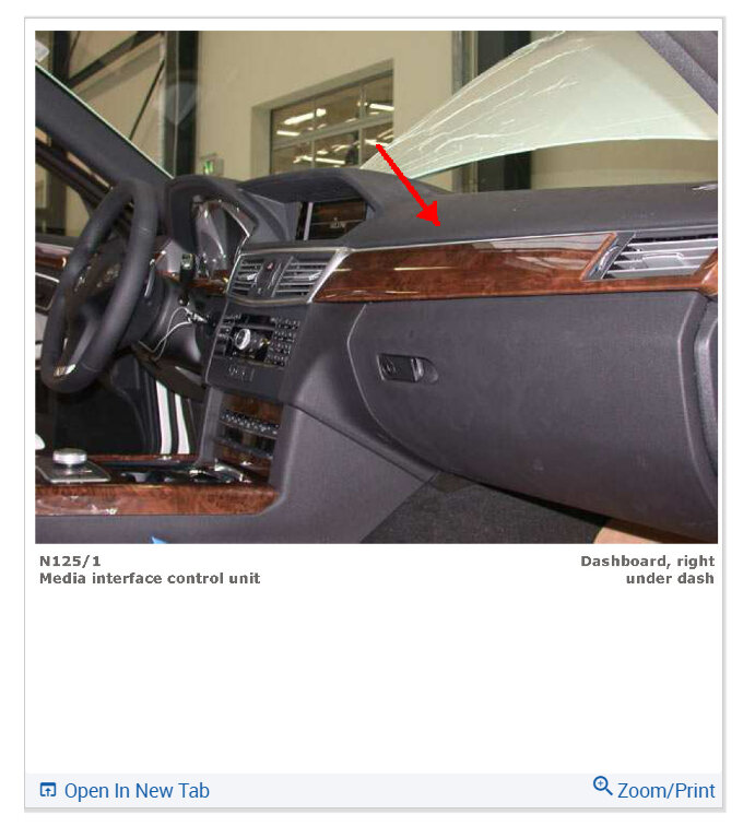

Hmm, it must be the LCD driver module. Have you run a CAN scan to see what comes up?

Okay, we are stuck with replacing the driver module or the entire unit.
