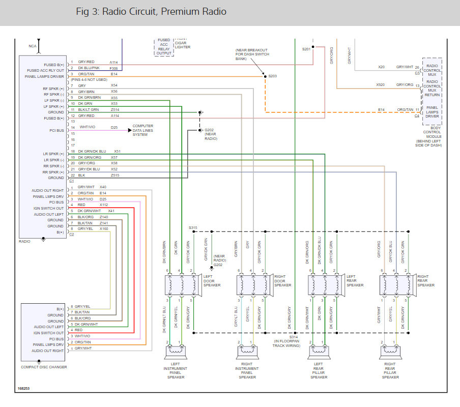

I would like to upgrade my audio system with a newer Chrysler system that supports either aux input or bluetooth input. I wonder which Town & Country audio systems will "plug n play" in my older car. My system has a CD player. Cassette and AM/FM as well as steering wheel controls which I would like to retain.
Thanks, Jim

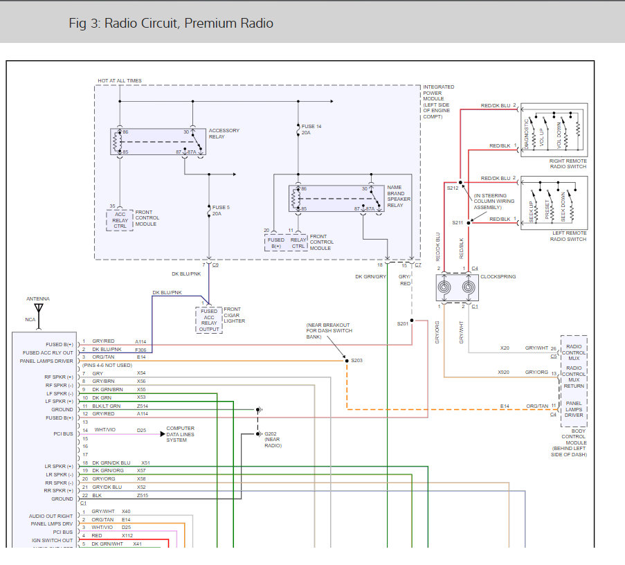

If the car didn't offer the stereo or option it will not be wired for the newer updated units. Here are the radio wiring diagrams for your car if you give me the year you want to upgrade to I can get those wiring diagrams so you can compare the difference. Check out the diagrams (below). Please let us know what you find.
