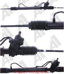

My 1992 Q45 is disabled because for the power steering failure,
1. Approximately what is the repair cost range?
2. Can be this repair be done in the drive way?
Please respond via email

Need to find out what is leaking. Fill pump have someone start car you look at the pump, hoses and rack see whereit is leaking. Hose $75 rack $1000

Don't know about a rack replacement in the driveway, you need to check the accessibility, but a remanufactured rack, which is all you can buy, runs from 281.00 to 534.00 at www.rockauto.com
https://www.2carpros.com/forum/automotive_pictures/62217_Rack_2.jpg
