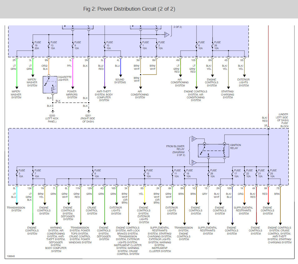

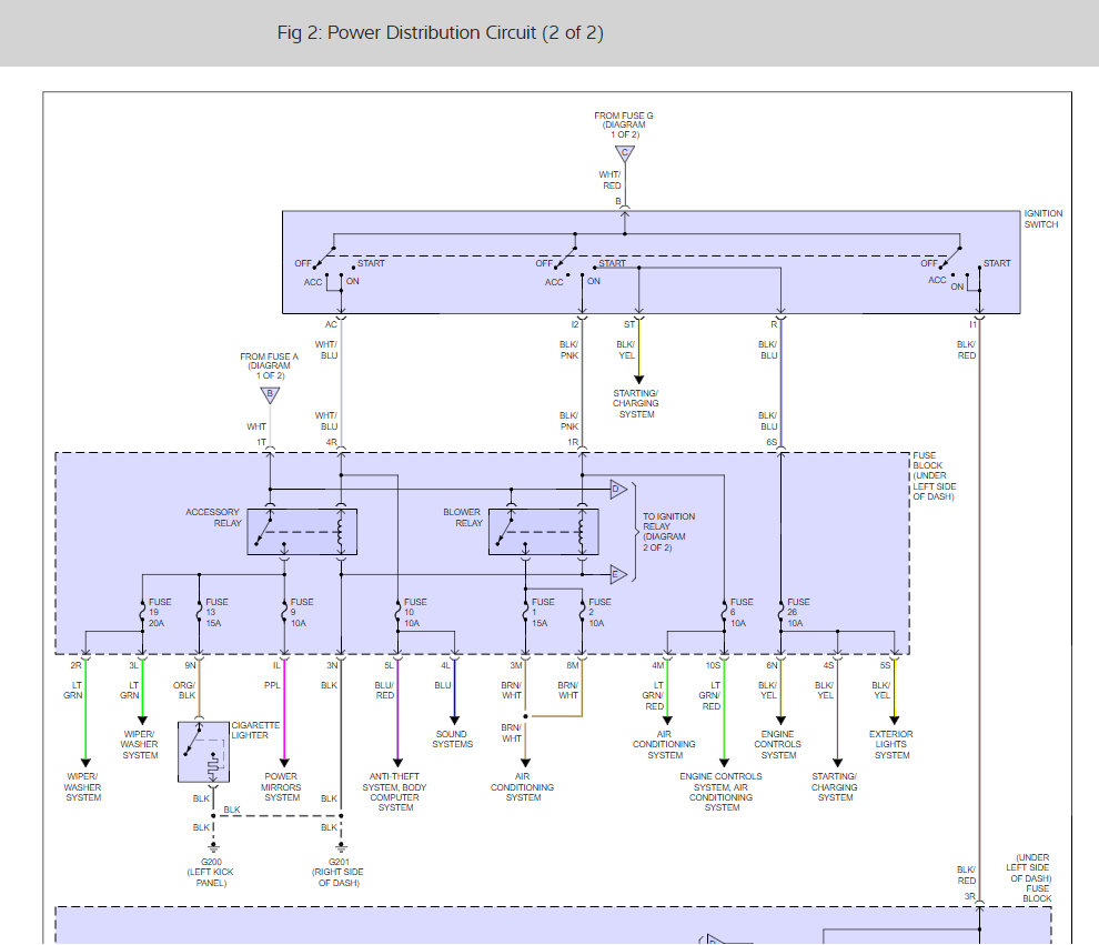

Need wiring diagram for ignition switch.
Wednesday, November 1st, 2017 AT 12:34 PM
KEN L
MASTER CERTIFIED MECHANIC
55,411 POSTS
Here is the ignition switch wiring diagrams (below) Please let us know if you need anything else to get the problem fixed. Cheers, Ken.
