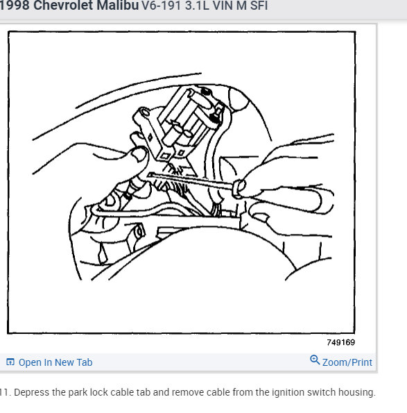

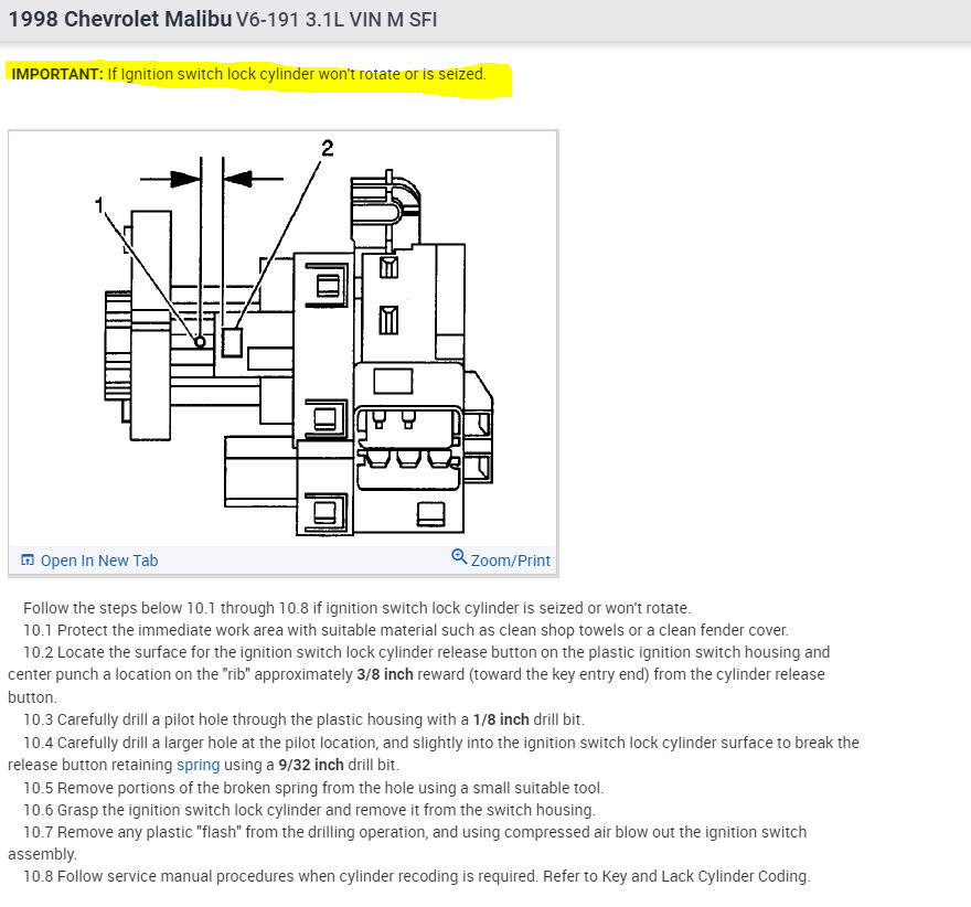

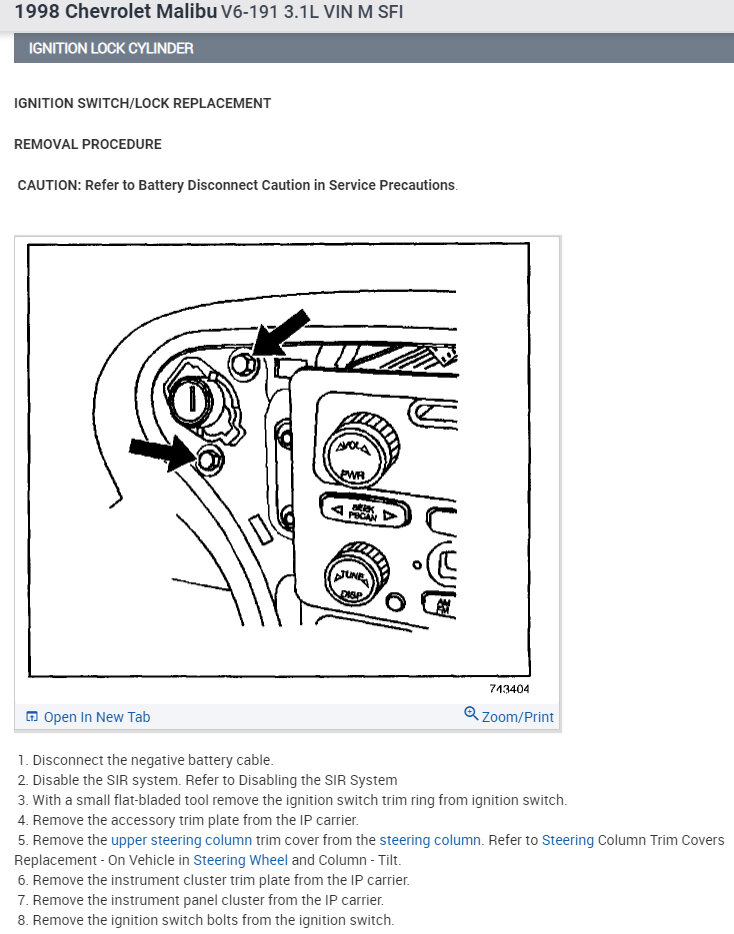

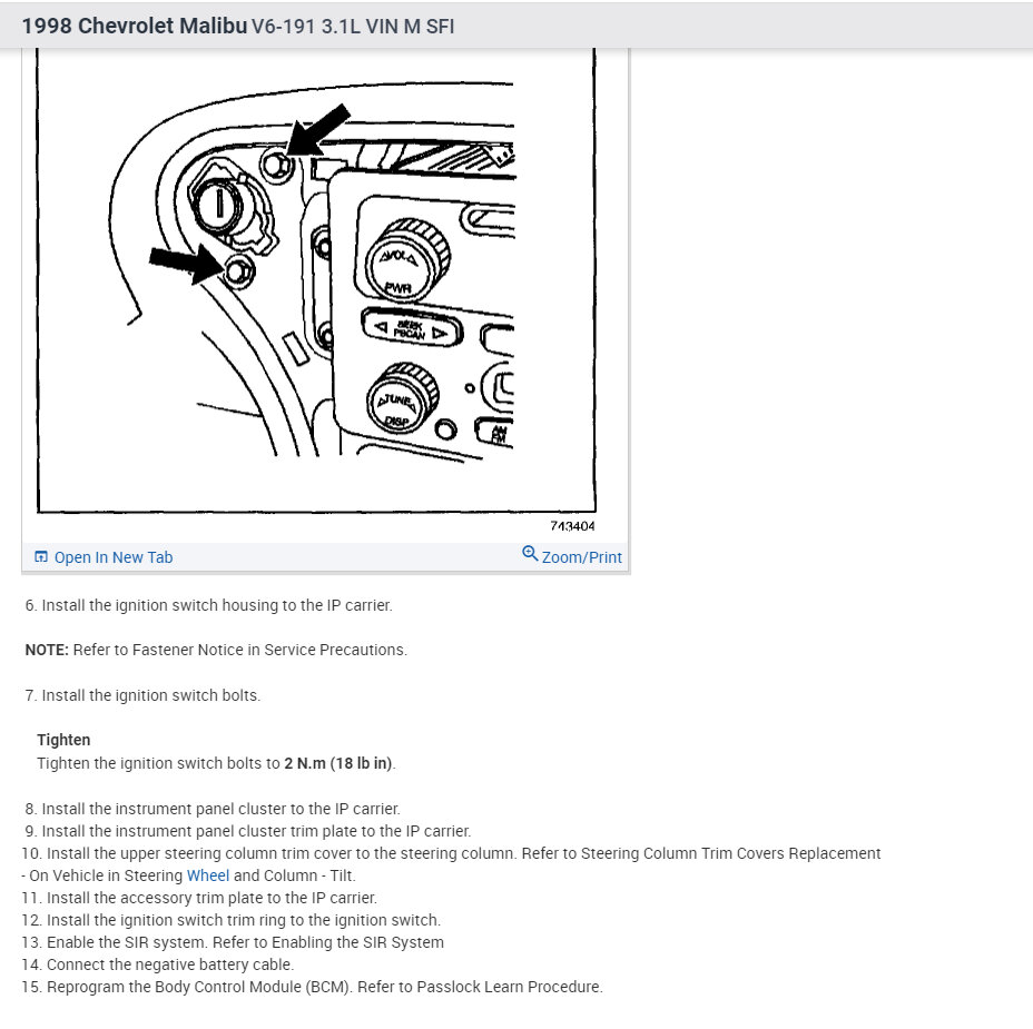

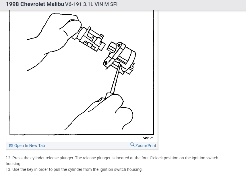

Lost the keys and need to pull cylinder. After pressing the release button, how do I pull out the cylinder without a Key?
Tuesday, November 22nd, 2022 AT 3:29 PM
SQM
MECHANIC
6,383 POSTS

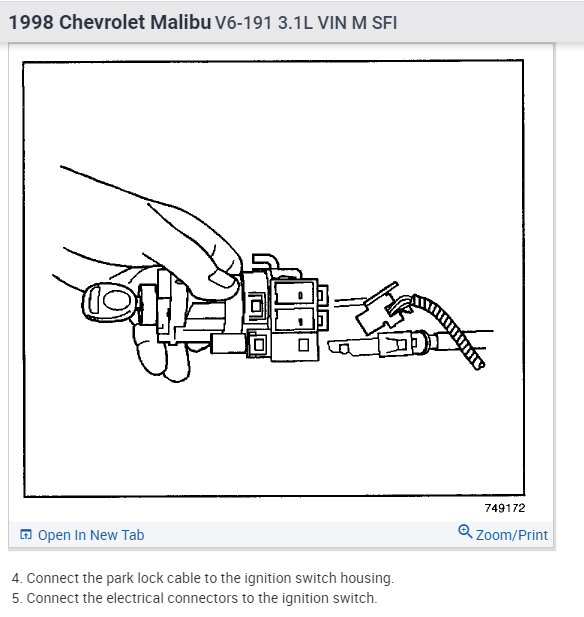

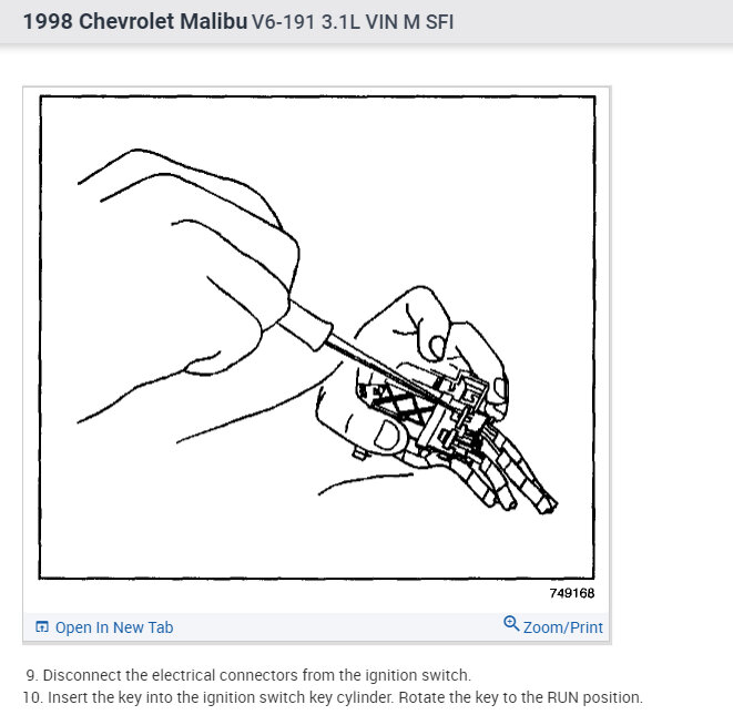

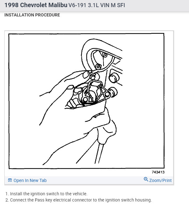

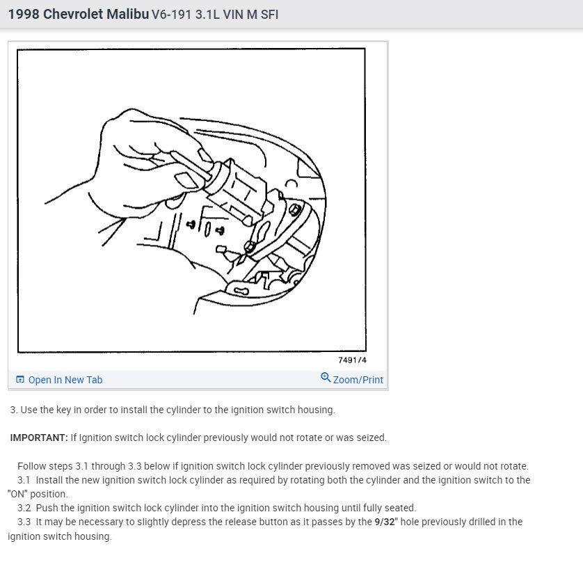

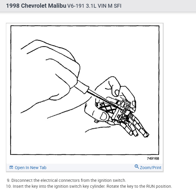

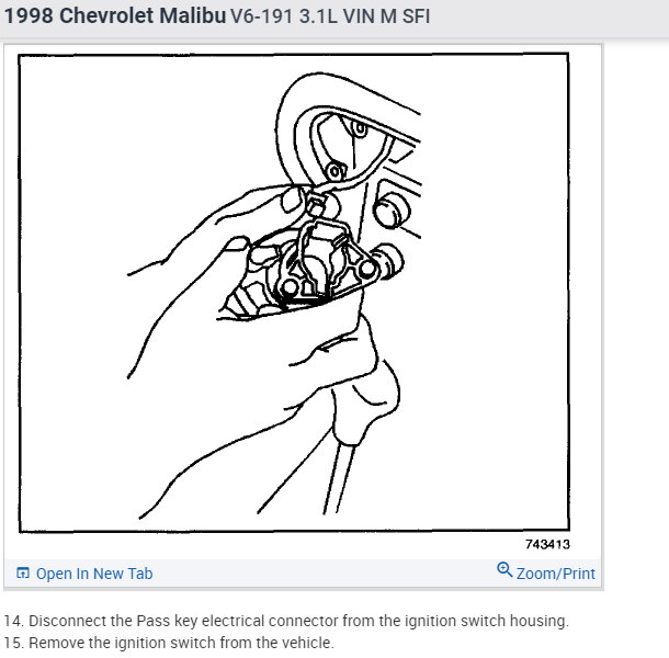

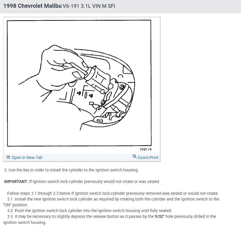

See attached below for the ignition lock cylinder replacement procedure, both with and without the key.
Keep in mind that the vehicle has to be programmed to accept the new key/cylinder.
Let me know of any questions.
