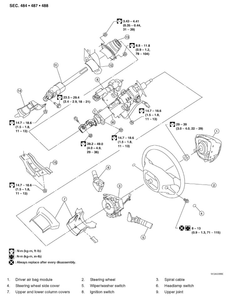

The Nat's ring around my ignition is broken. I found a new switch with the key at a junk yard. I can also get the body control module. (All for about $35.00) My question is if I change the switch along with the BCM would it work or would I still have to go get it reprogrammed? Thanks for any help.

Yes it should work here are is a diagram to help you get the switch changed out.

We finally got the switch and bcm changed. It won't start. It's like it's not getting fuel. It will turn over but that's all. Any thoughts?

Is the security light flashing? If so it needs to be reset Here is a guide to help you.

Thanks. I will. It says I need to use the key fob in the process for Nissan. I don't have one. I'll try the other things and let you know. I really appreciate the help.
