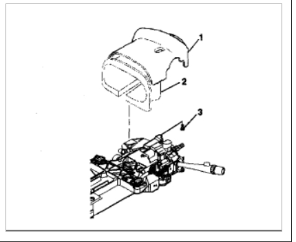

Our steering wheel does not lock. We do not have to apply our foot to the brake to remove from park, and our key is stuck in the ignition.
Anyone have some help for these problems?

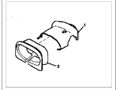

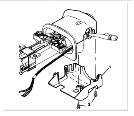

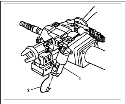

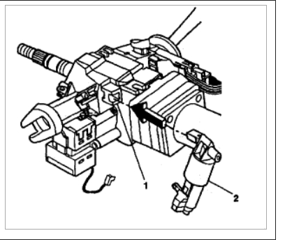

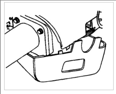

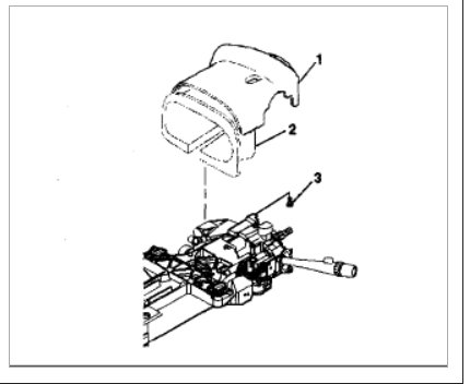

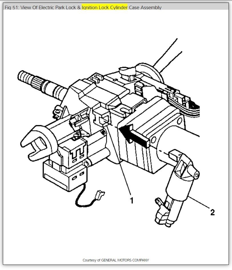

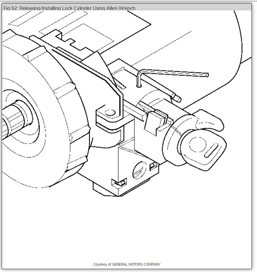

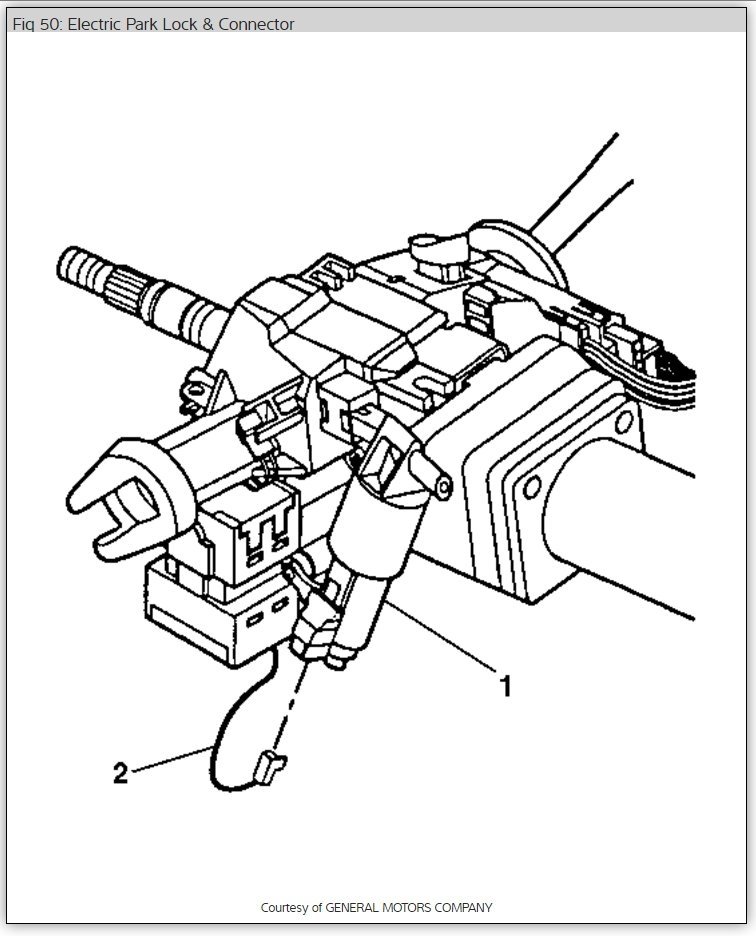

You have a problem with the interlock system or ignition tumbler of your car. You will need to disassemble the column cover and then start looking for broken parts. The deterrent lock is the first place I would start. Theft deterrent lock replacement.

My ignition is stuck wont turn off or forward. The truck is still running has been since 10:00 pm it is now 4:00 am. Key stuck nothing will move it.

Pull out the ignition fuse the will shut it off. So the key wont turn from the run position?Sounds like the ignition housing is jammed up.

My key is stuck in the ignition and won't go back into the lock position. The gear shift is in between the front seats. I am at a total loss about what to do about it. Help. And the car won't start. I replaced the started because I knew it was going bad and now I hear the starter turn over but it is not engaging the flywheel. I've check the flywheel for damage and there is none. It also turns. What could be my problem. No problems with this car until this.

It sounds like you have a bad tumbler. Have that checked. You may want to lube it to see if that helps. Also, have you checked to see if you are getting spark and fuel to the engine?

Check for broken wires down by the shifter. There is a switch down there to release the key.

I turned the key to start my car. It stayed in the start position. I can not turn it off or move the key at all. What is the problem and how do I fix it.

Day two: Google is wonderful! I researched the issue and narrowed it down to my ignition lock cylinder. I bought the part, gave it to my husband and - tada - its fixed! It was the starter spring that went bad on the cylinder. It looks like a scary job but once you get to the assembly (behind all the plastic covers) it only took about 1 hour.
