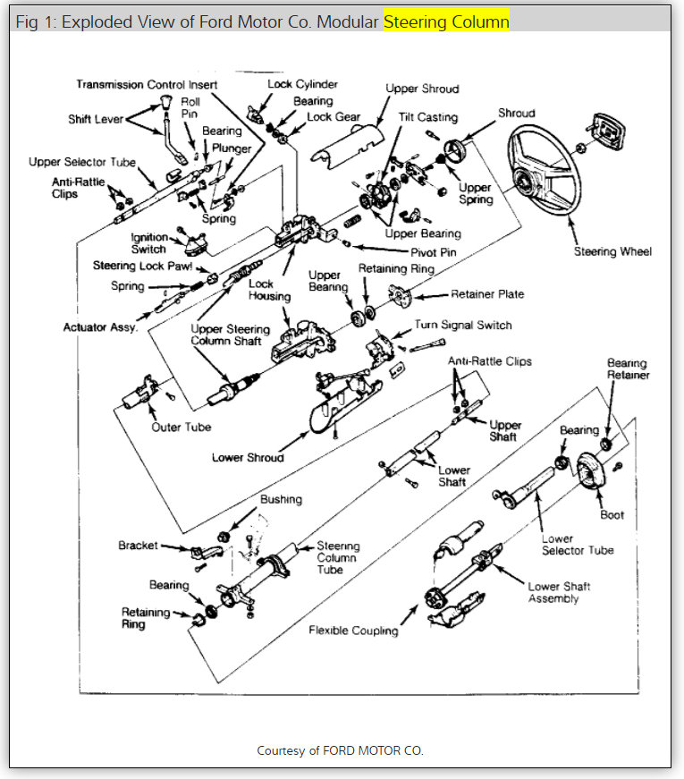

I took out the ignition lock cylinder and now it is not going back into place and I have no idea why?

You must time the tumbler lock to the mechanism inside the column look to make sure they are lined up.
Here is a diagram to help you see how to do the job.
