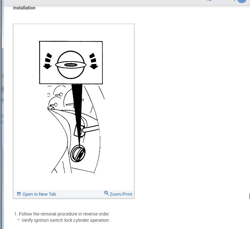

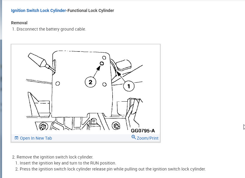

How to switch out the ignition lock cylinder?
Saturday, August 22nd, 2020 AT 1:09 PM
MECHANIC
18,907 POSTS
I am attaching the info on how to remove it and replace it. It is pretty straight forward.
There is a release button that you need to press and then it pulls out.
Let us know if you need more info. Thanks
