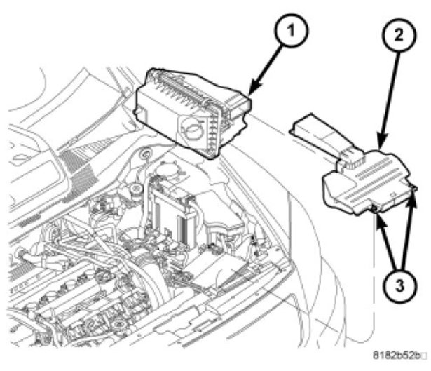

Here you go! Please let us know how it turns out

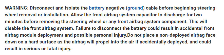

Remove air cleaner fresh air duct (2) and disconnect and isolate negative battery cable at battery. Refer to BATTERY, Removal.

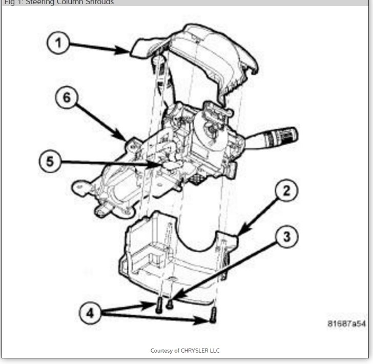

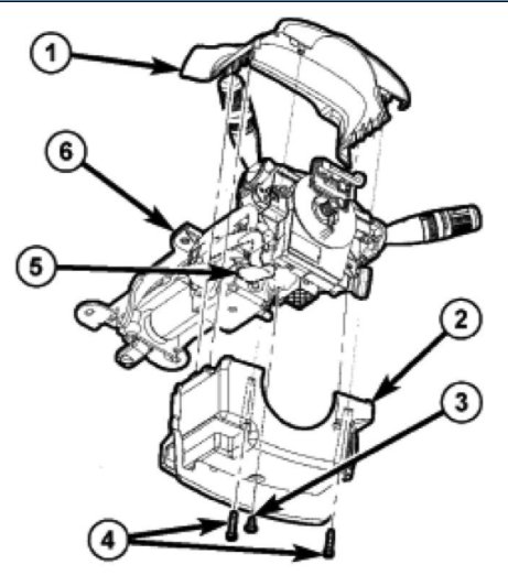

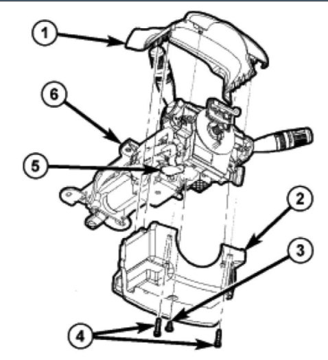

Fig 1: Steering Column Shrouds

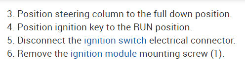

Remove upper (1) and lower (2) steering column shrouds. Refer to SHROUD, Steering Column, Lower, Removal and SHROUD, Steering Column, Upper, Removal.

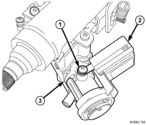

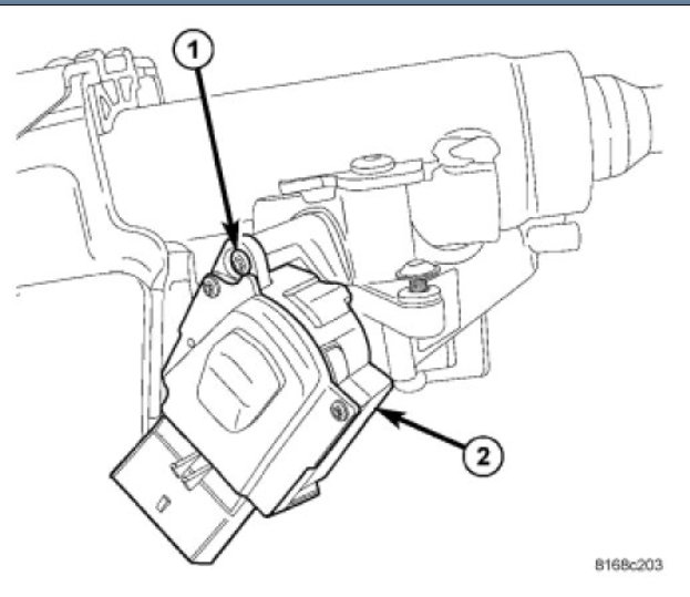

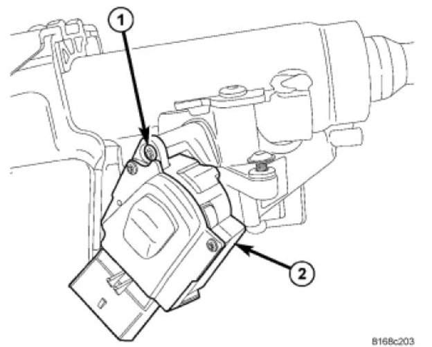

Fig 2: Ignition Switch Mounting Screw
Position steering column to the full down position.
Position ignition key to the RUN position.
Disconnect the ignition switch electrical connector.

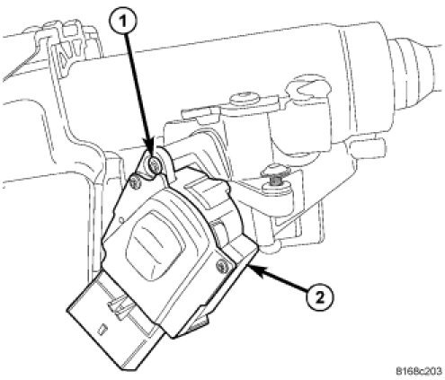

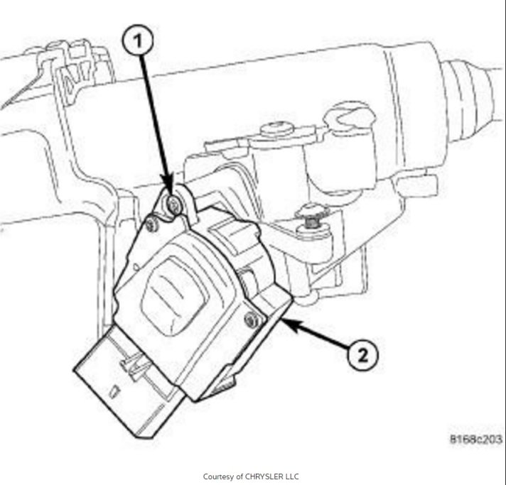

Remove the ignition module mounting screw (1).

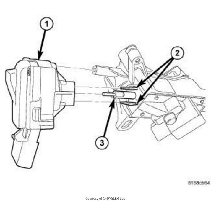

Fig 3: Ignition Switch Removal/Installation

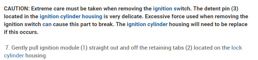

CAUTION:

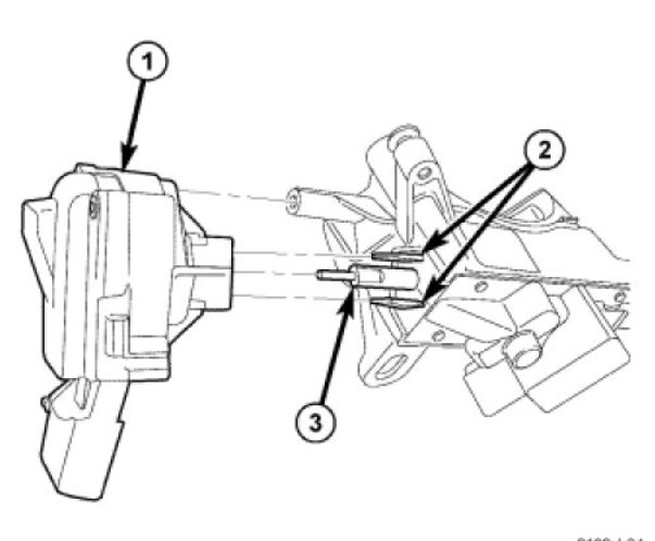

Extreme care must be taken when removing the ignition switch. The detent pin (3) located in the ignition cylinder housing is very delicate. Excessive force used when removing the ignition switch can cause this part to break. The ignition cylinder housing will need to be replace if this occurs.
Gently pull ignition module (1) straight out and off the retaining tabs (2) located on the lock cylinder housing.
View Full-Screen
Pay close attention not to damage the detent pin in the lock cylinder housing when removing the ignition switch. Gently rotate the ignition switch counter - clockwise until the part of the ignition switch where the electrical connector (1) plugs in clears the tilt lever (2) as shown in illustration. Remove the ignition switch from the lock cylinder housing.

Fig 5: Ignition Switch Rotated
CAUTION:
Carefully install the ignition switch to the slotted detent pin. If installed forcefully the detent pin will break the ignition cylinder lock housing will have to be replaced.
Pay close attention not to damage the detent pin in the lock cylinder housing when installing the ignition switch Position the ignition switch (1) as shown in order in illustration to clear the tilt lever (2).
Fig 6: Ignition Switch Removal/Installation
Ensure the ignition module is in the RUN position and the actuator shaft in the lock housing is in the RUN position.
Align the ignition switch (1) with the detent pin (3), and retaining tabs (2) located on the lock cylinder housing. Carefully install the module, snapping it into place over the retaining tabs. Make sure the ignition switch is fully seated.

Fig 8: Steering Column Shrouds
Install upper (1) and lower (2) steering column shrouds. Refer to SHROUD, Steering Column, Lower, Installation and SHROUD, Steering Column, Upper, Installation.

IGNITION SWITCH [ DISASSEMBLY ]
Fig 9: Ignition Switch Mounting Screw
NOTE:
Lock cylinder housing removed from column.
Remove the ignition switch (2) mounting screw (1).

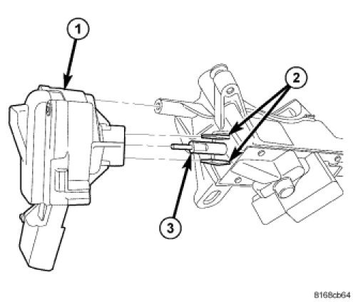

Fig 10: Ignition Switch Removal/Installation
Pull the switch (1) straight out and off the retaining tabs (2) located on the lock cylinder housing.

Fig 11: Ignition Switch Removal/Installation
Ensure the ignition switch is in the RUN position and the actuator shaft in the lock housing is in the RUN position.
CAUTION:
Use care when installing the ignition switch on the lock cylinder housing to avoid damaging the key-in plunger (3).
Align the ignition switch with the key-in plunger (3), actuator shaft and retaining tabs (2) located on the lock cylinder housing. Carefully install the switch, snapping it into place over the retaining tabs.

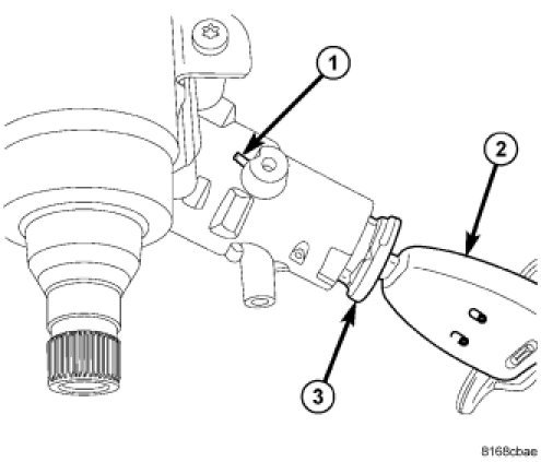

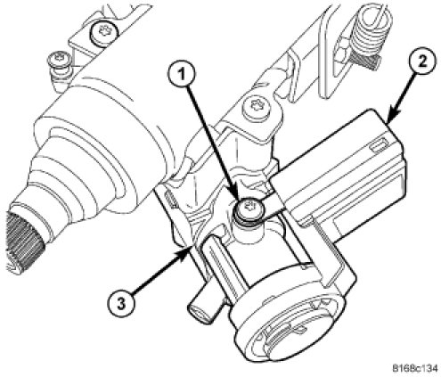

Remove screw (1) fastening the SKREEM/WCM (2) to the lock cylinder housing (3).
Unhook the SKREEM/WCM (2) retainer fingers from the lock cylinder housing (3) and position the SKREEM/WCM (2) back on the lock cylinder housing (3).
Insert an appropriate tool into the slot (1) formed into the lock cylinder housing.
Depress the key cylinder retaining tab.
Pull key cylinder (3) and key (2) straight out of the lock cylinder housing as one unit.

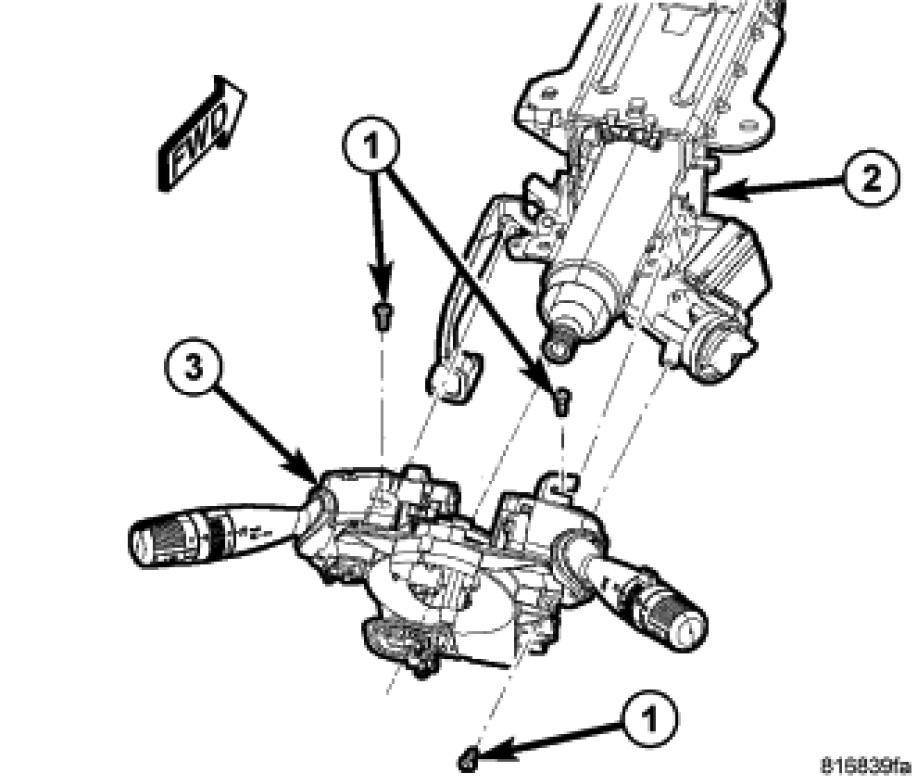

I need to know step by step how to remove and replace the ignition lock cylinder.
Thursday, December 31st, 2020 AT 9:46 AM (Merged)
  • 110,192 POSTS
I'm not sure what engine this has, so I went with a 1.8L. What you listed isn't an option.
Here are the directions. The attached pics correlate with the directions.

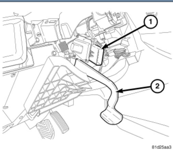

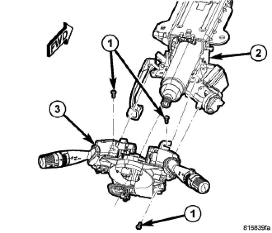

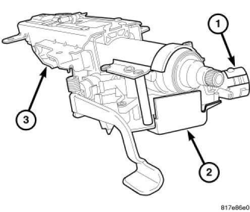

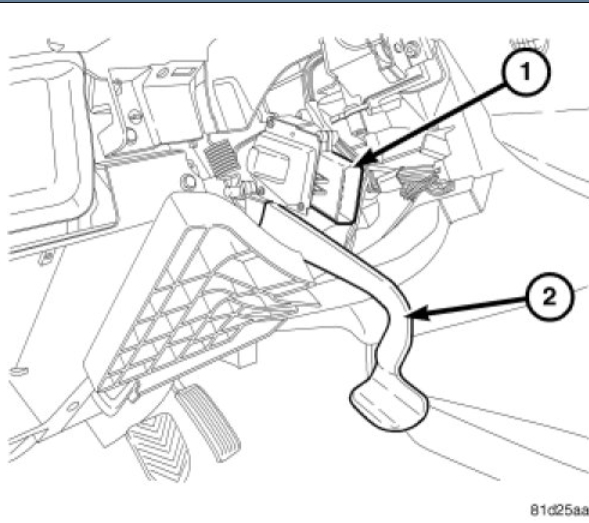

1. Access and remove the Steering Column Control Module (SCCM) (3) from the steering column (2).
Pic 2

3. Remove the screw (1) fastening the SKREEM/WCM (2) to the lock cylinder housing (3).
4. Unhook the SKREEM/WCM (2) retainer fingers from the lock cylinder housing (3) and remove it.

5. Insert the key (2) and turn the key cylinder (3) to the RUN position.
6. Insert an appropriate tool into the slot (1) formed into the lock cylinder housing depressing the key cylinder retaining tab.
7. Pull the key cylinder and key straight out of the lock cylinder housing as one unit.

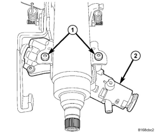

Pic 5

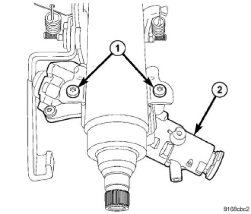

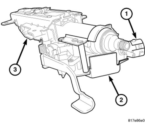

8. Using a Tamper-Proof Torx(R) Plus (five point) 30 bit, remove the two screws (1) fastening the lock cylinder housing (2) to the column.
9. Remove the lock cylinder housing from the steering column.
Pic 6

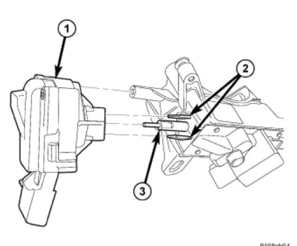

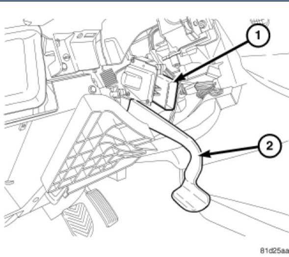

10. Remove the ignition module (2) mounting screw (1).
Pic 7
11. Pull the module (1) straight out and off the retaining tabs (2) located on the lock cylinder housing.

Pic 7
NOTE: Ignition module must be installed prior to lock housing installation on column. Otherwise, the tilt lever will obstruct installation of ignition switch.
1. Ensure the ignition module is in the RUN position and the actuator shaft in the lock housing is in the RUN position.
2. Align the ignition module with the pin (3), actuator shaft and retaining tabs (2) located on the lock cylinder housing. Carefully install the module, snapping it into place over the retaining tabs.
Pic 8
3. Install the ignition module (2) mounting screw (1). Tighten the screw to 2 Nm (18 in. Lbs.).

15. Install the Steering Column Control Module (SCCM) (3) and all components removed to access it.
16. Check operation of all steering column-mounted components.
