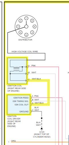

Cam swap have fuel but no spark. replaced ignition coil with oil pressure switch with idle control valve. the engine started strong fast idle gave it some gas to idle around 2,000 rpm's noticed the rpm were jerking down wards.. I turned it off and wanted to turn it on again and nothing.. checked coil for spark and nothing.. I checked the connection i have power feed but no ground with the key on.. also I have RPM reading on the gauge. Need help please.

Good morning, yes the distributor turns.. I checked to see if the coil is throwing spark to a screw that has ground and nothing.
Dec 28, 2019 at 11:26 AM
Okay, verify power to the positive side of the coil. If you do, then use a test light on the negative side and crank the engine. Tell me if the test light flashes.
Dec 28, 2019 at 11:35 AM
DAVISMELODY6669
  • 65 POSTS
The clip on negative of the battery I point the test light on power feed it lights up..with key on n while cranking it flickers off and switching the clip to positive on battery I have no ground even while cranking, that's the connection for the coil.. and for the ignition module I have ground and power feed using the test light..
Dec 28, 2019 at 11:55 AM
If it is flashing then it is commanding the coil to fire. That would indicate a bad coil.
Dec 28, 2019 at 12:03 PM
DAVISMELODY6669
  • 65 POSTS
If the power feed is flashing then it's a bad..am I supposed to get ground from the connection too?
(The coil connection)
Dec 28, 2019 at 12:10 PM
Forget about the ground. That is not relevant to this test. You are looking for the module turning the coil on and off.
Dec 28, 2019 at 12:11 PM
DAVISMELODY6669
  • 65 POSTS
Okay with a charged battery I'ma do the test light on the power feed connection of the coil while cranking if it flickers means to swap out the bad coil right?
Dec 28, 2019 at 12:48 PM
Correct.
Dec 28, 2019 at 1:04 PM
DAVISMELODY6669
  • 65 POSTS
Doesn't flicker just gets little dim while cranking and I lost rpm signal.
Dec 29, 2019 at 3:23 PM
Okay, then replace the module back by the coil.
Dec 29, 2019 at 4:09 PM
DAVISMELODY6669
  • 65 POSTS
Do I replace both?
Dec 29, 2019 at 6:41 PM
Just the module.

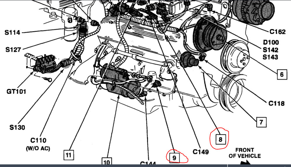

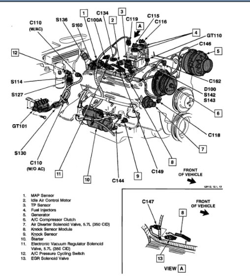

Here's my dilemma: I'm wanting to install a part that I can't, nor anyone else I've asked for that matter, seem to find. I'm looking for the location where the Electronic Spark Controller (ESC) is located on my truck listed above K1500, 5.7L V-8, Auto transmission. It's the last piece, other than a new computer, to try and fix the problem I've been having in regards to engine bog down when it gets hot or when it's humid. I've been looking for this holy grail all morning and have asked numerous local mechanics as well all with the same result. Help! lol and thanks in advance. :)

DANNY L
  • 5,648 POSTS
Hello, I'm Danny.

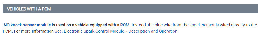

Here is the information you requested. If your truck is equipped an ECM- engine control module it has an external knock sensor and module. If your truck is equipped with a PCM-powertrain control module it is built into the PCM and you won't find it externally. I've attached pictures below showing the ecm system with the external sensor and module circled in red showing their location. I've also attached a picture of the PCM system notes. Hope this helps and thanks for using 2CarPros.
