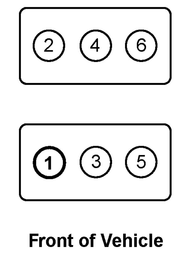

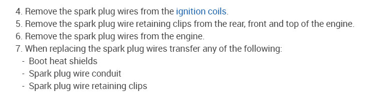

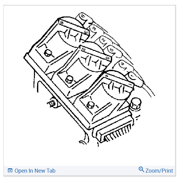

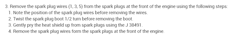

I need the order of the spark plug wires.
Thursday, October 26th, 2023 AT 7:20 AM
KEN L
MASTER CERTIFIED MECHANIC
55,130 POSTS

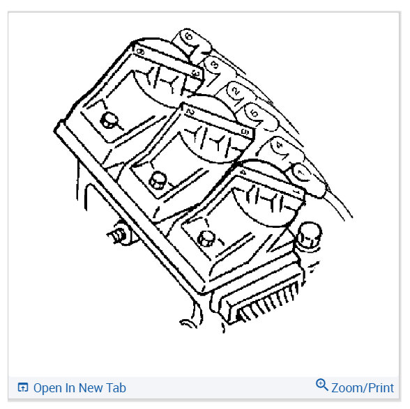

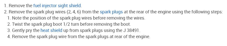

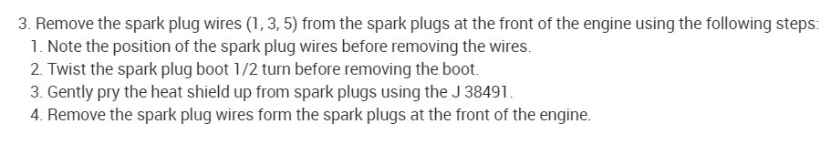

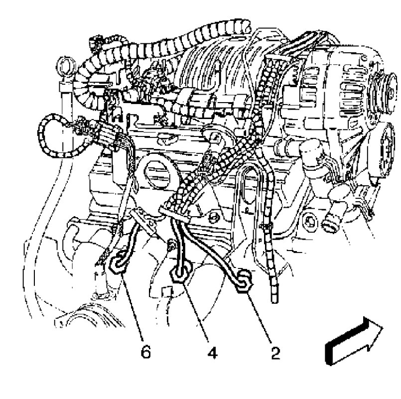

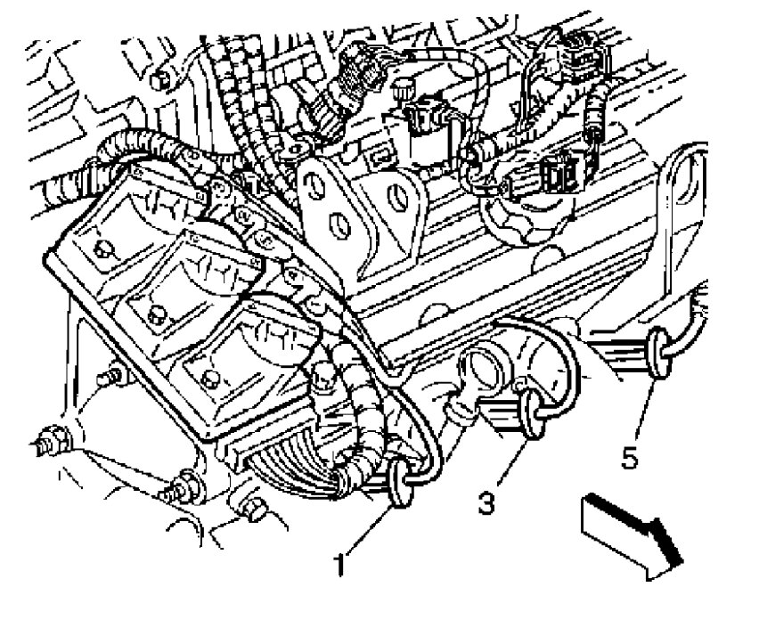

Here is the spark plug wire installation instructions.
Firing Order. 1-6-5-4-3-2
Check out the images (below). Please let us know if you need anything else to get the problem fixed.
