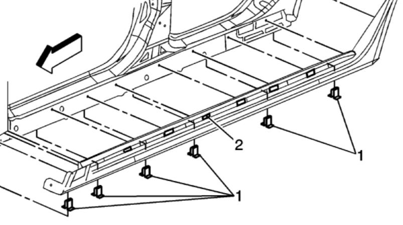

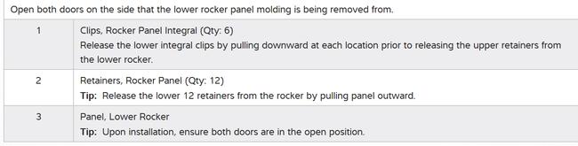

I need instruction on how to put the right side rocker back onto the car with the new plastic clips do I put the lips on panel I need instruction on how to put the right side rocker back onto the car with the new plastic clips do I put the lips on panel
Thursday, March 19th, 2015 AT 11:09 AM
HMAC300
  • 48,601 POSTS
All clips should be on the panel to replace and make sure all old ones are out of slots.
