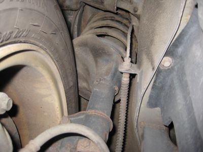

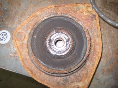

Ok... so I take the car in today, they replace the struts and the strut mounts ($783.24) and I had to get a new tire. The tire thing was valid, there was a huge bulge in one that I had not noticed. I had a coupon for $100, so I walk out spending $873.21 total. THE CAR STILL MAKES THE SOUND!!!
I AM SOOooOOOooOoOOooO pissed off, man.
The sound is MUCH quieter. MUCH less noticable, but still there none the less.
I will upload pix of what they saw. Frankly, I trust you- I wonder if you have an idea of what I should do next?? I have 12 month/12k miles to take it back... but did they just give me parts I don't need?? I don't know what to ask them to look at, and I am hesitant to spend any more $$. I was told that the "struts need to settle"... which sounds like a load of crap to me...
Please give me any advice you can think of!

Well, the struts really do need to settle first before you come to any conclusion about that. See if the noise goes away. Give it a few days, maybe a week.
Did they inspect the mounts for strut assembly? Usually the mounts are replaced along with the struts so find out if they did. If they didnt', the noise can often be made by a mounting problem and not the shock or strut itself. The strut mount itself may be worn enough to cause the strut to move up and down resulting noise. Another common cause is that the shock or strut may not be tight enough causing the unit to have play and again make noise. Of course I would certainly hope that they tightened them well so I don't believe this would be the case.
Let me know how they sound in a few days and I will follow up.
