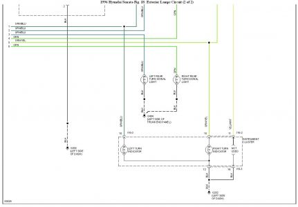

The side lights stay on when the car is turned off. Disconnecting the leads from the back of the lights still drains the battery. I thought it might be a stuck relay but I've tried disconnecting the relays, in the housing under the bonnet and the lights stay on.

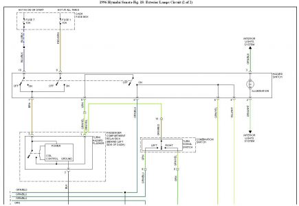

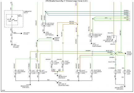

If the relay is removed, the lights should go off as the power source has been disconnected.
Here are the schematics and you can see it is impossible for the lights to stay on if the relay is removed.
https://www.2carpros.com/forum/automotive_pictures/192750_ExteriorLights96SonataFig17a_1.jpg
https://www.2carpros.com/forum/automotive_pictures/192750_ExteriorLights96SonataFig17b_1.jpg
https://www.2carpros.com/forum/automotive_pictures/192750_ExteriorLights96SonataFig18a_1.jpg
https://www.2carpros.com/forum/automotive_pictures/192750_ExteriorLights96SonataFig18b_1.jpg

I just remembered 2 other possible causes.
If the antitheft system is non factory, it is possible the alarm control unit is linked to the lights directly and bypassing the taillight relay. If it is faulty, it can cause the problem. For factory system it would not occur as the system needs the taillight relay to work.
The other possibility would be a wiring fault. The light wires have been fused to a power supply possibly due to a shorting and overheating has caused the wires coverings to melt.
