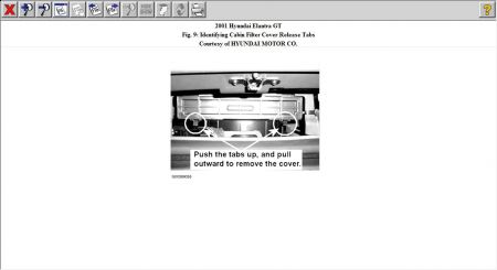

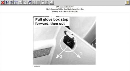

In my car, I am not able to find out the place where tthe cabin air filter is installed. Can anyone point out for me pls? Thanks.
Tuesday, May 26th, 2009 AT 10:04 PM
MECHANIC
75,992 POSTS
Its behind the glove box
