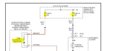

2000 Hyundai Elantra Two Wheel Drive Automatic 160000 miles
my battery went dead so I charged it over night.I had the charging system tested and the alternater showed it was not charging, I put a new one in and it still shows it's not charging. Is there a external regulater or fuse I should check. Thanks david

Hi there,
You will have to check the fuses, fusible links and the resistor are all serviceable, start here.

DLM41166
Thanks mark, all that checked out good, took old alt in and it was bad, they then checked new alt and it was bad too. I will now put in another alt they gave me, hope that does it, thanks for the help. Will update dave

DLM41166
Put new alt in, same thing. After pounding my head on the engine, I noticed when you reved the motor the belt didn't realy speed up all that much, I took the belt off and all the ribs were gone, it looked fine on the outside, works great now, my head still hurts. Thanks again, dave
