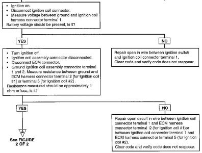

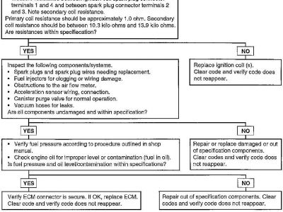

Can you get the engine scanned again, and give the codes? From the look of it, (just a guess, either the wires or your coil pack), but don't change anything until we get the proper diagnostic..

Got the code today - Code P0-304 (misfire in cylinder #4). Any suggestions?
Thursday, February 5th, 2009 AT 4:54 PM
ZACKMAN
  • 4,202 POSTS

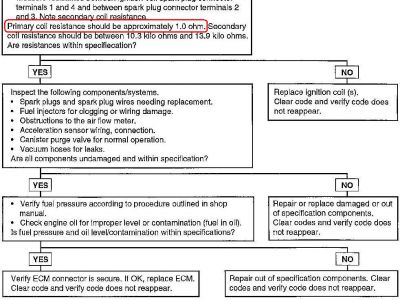

1. Pull spark plug #4. Check the gap. Should be about .04". You did get NGK BKR6ES-11, right?

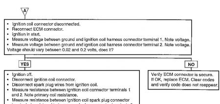

2. Next test your coil. You have 2 coils in 1, and each coil has 2 plugs connected to it. Check the plug wires (one at a time), make sure that there is no burn marks from spark "jumps", frayed or cut wires. Here is how to check the coils.

Just realize you are missing the secondary coil test.
Back to your question about the spark plug. I got my info from Hyundai's TSB. BKR5ES-11 is equivalent to BKR6ES-11, except it is a hotter plug. It your driving is more highway than city or stop-and-go, you have the better plug. But if you do more city and stop-and-go, you may want to consider going with the 6, colder plug.
I am not a fan of platinum plugs unless it is specifically required the OEM specs. I am not saying that they aren't good, I just have always follow what the OEM specs. Do this, while you are checking the coils, pull #1 and #4 plugs, and compare them. (It would be useful if you can snap a picture and post them.) Check if they are burning off differently. And then swap them. Put #4 plug into #1 cylinder and vice versa. I would be surprise if your next check engine light will show #1 misfire. If it is, then you know that particular plug is defective.

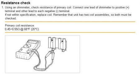

Aight got it done. I did this morning, kinda dark and a lil chilly, so I hope I got it right.
Primary -.9 & 1.1
Secondary - 11.98 & 11.79

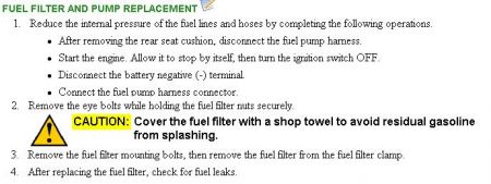

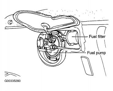

I am gonna give the primary another shot this evening when I get in from work. Also, if you could help me locate the fuel filter on the car as well. This is my wifes car and can only go on what she tells me. When she gets gas it bogs down a little.

You may want to check the primary again. Those numbers are way off.
Fuel system
https://www.2carpros.com/forum/automotive_pictures/55316_04accentfuel_1.jpg
https://www.2carpros.com/forum/automotive_pictures/55316_04accentfuel_2.jpg

I believe your coils are fine. Look at my first post. The diagram does say that the coils should be around 1 Ohm. As each coil is double-ended and serves two cylinders, I would imagine the table is meant for each cylinder.
https://www.2carpros.com/forum/automotive_pictures/55316_04accentp0300_3_2.jpg
I would then continue with the troubleshooting and focus on fuel delivery. Check your fuel filter and possibly cylinder 4 injector clogging/leaking.

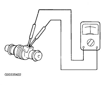

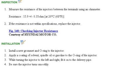

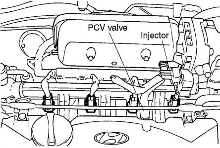

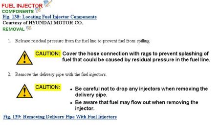

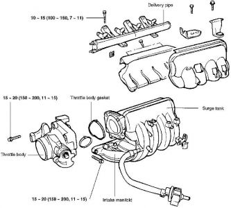

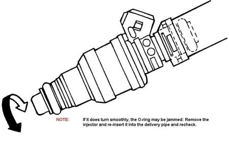

Alrighty. We're getting the fuel filter changes tomorrow. I will get them to look at the injectors. You got any diagrams on removal of those?
Friday, February 20th, 2009 AT 5:31 AM
ZACKMAN
  • 4,202 POSTS
https://www.2carpros.com/forum/automotive_pictures/55316_04accentinjector_1.jpg
https://www.2carpros.com/forum/automotive_pictures/55316_04accentfig138_1.jpg
https://www.2carpros.com/forum/automotive_pictures/55316_04accentfig139_1.jpg
https://www.2carpros.com/forum/automotive_pictures/55316_04accentinjector2_1.jpg
https://www.2carpros.com/forum/automotive_pictures/55316_04accentfig140_1.jpg
https://www.2carpros.com/forum/automotive_pictures/55316_04accentfig141_1.jpg
