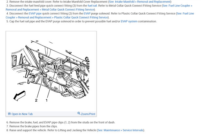

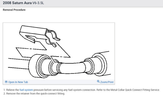

I am trying to remove the 2 lines (non-electrical, vacuum?) Going to the Canister Purge Solenoid. They appear to have have quick connect clips. How do your remove these 2 lines with these quick connect clips on them? I don't want to damage anything trying to take them off of the solenoid.
Thanks in advance for any help you can provide.
Dec 8, 2015 at 11:06 AM
SATURNTECH9
  • 30,869 POSTS

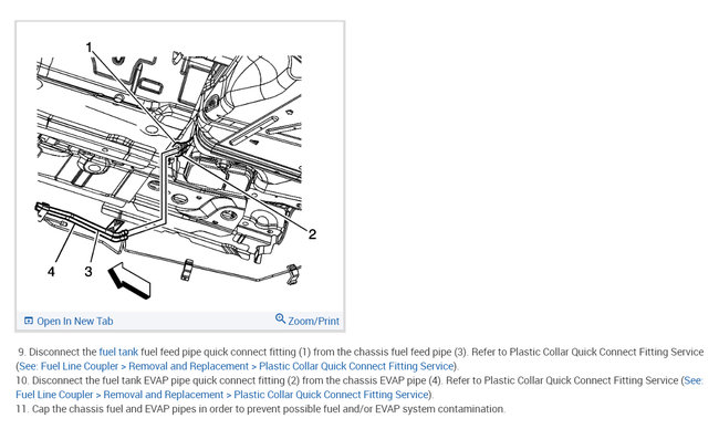

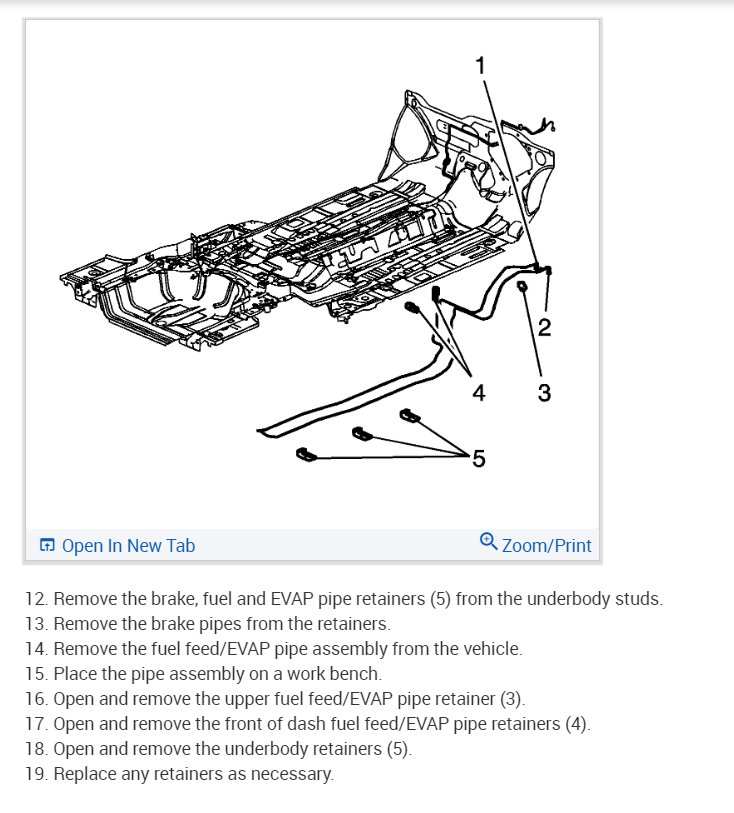

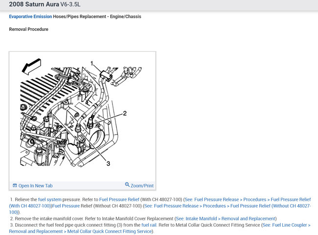

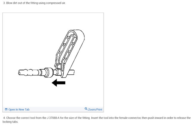

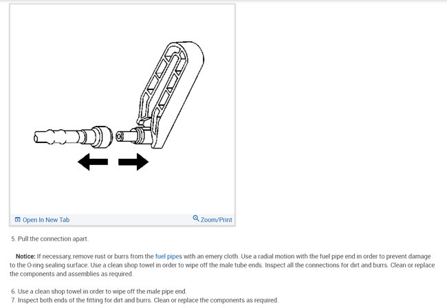

There is a special tool that is used here are diagrams and instructions on how to remove the EVAP lines on your car.
This video will show how to remove the lines. ITs for fuel lines but the connectors are the same.
https://youtu.be/Boi0DPXVHbM
