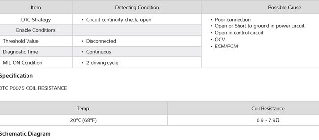

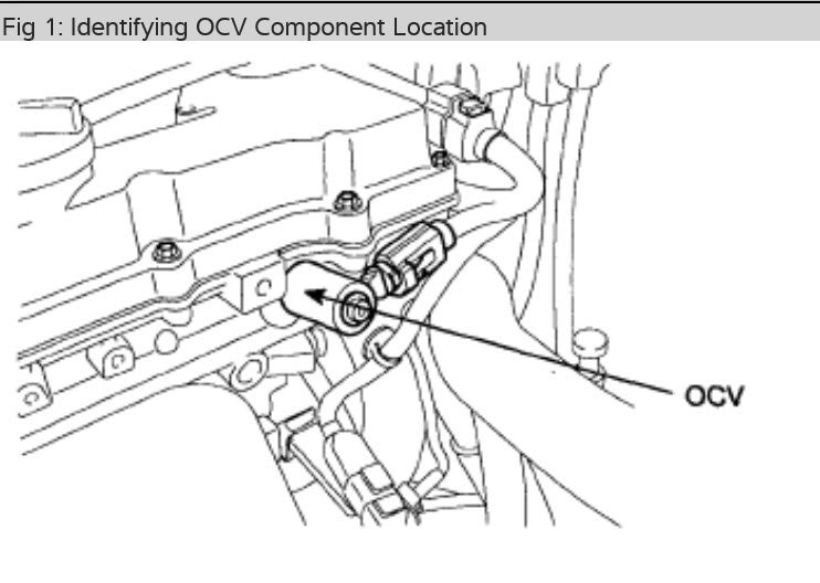

I have check engine light is on I scene I get code p0075 says intake velve contol selinoid what should I do to fixed

Check ocv valve and check for partial blockage in line. See pics

Thanks I check it it was disconnected then I connected now it ok
