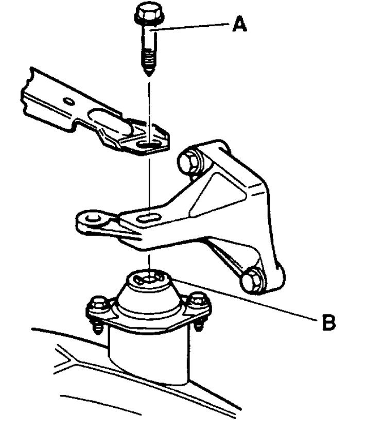

So, the flywheel came off loose.
How do I replace the flywheel?
Do I need any special tools?
Do i need to replace the clutch?
What do I need to remove to take out the transmission?
What do I need to remove to take out the flywheel?
Pictures, torque specs and sequence are greatly appreciated!
Apr 17, 2024 at 7:30 PM
  • 54,144 POSTS

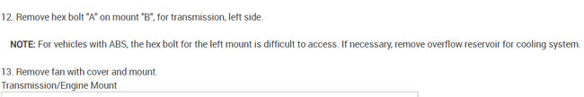

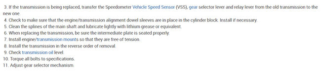

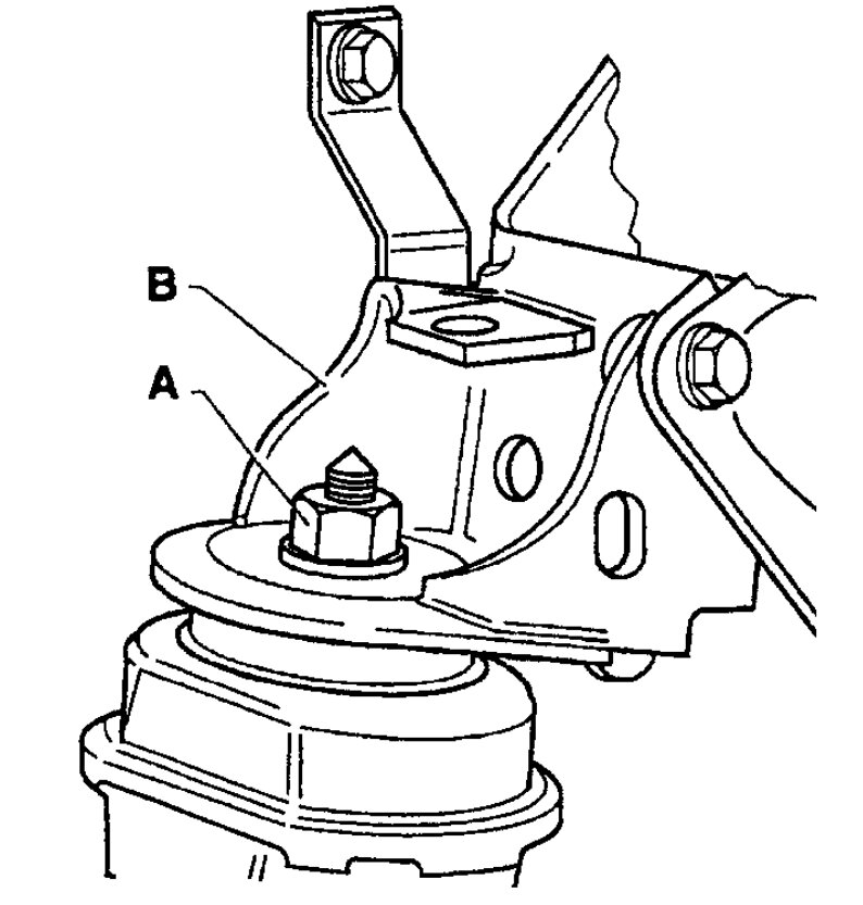

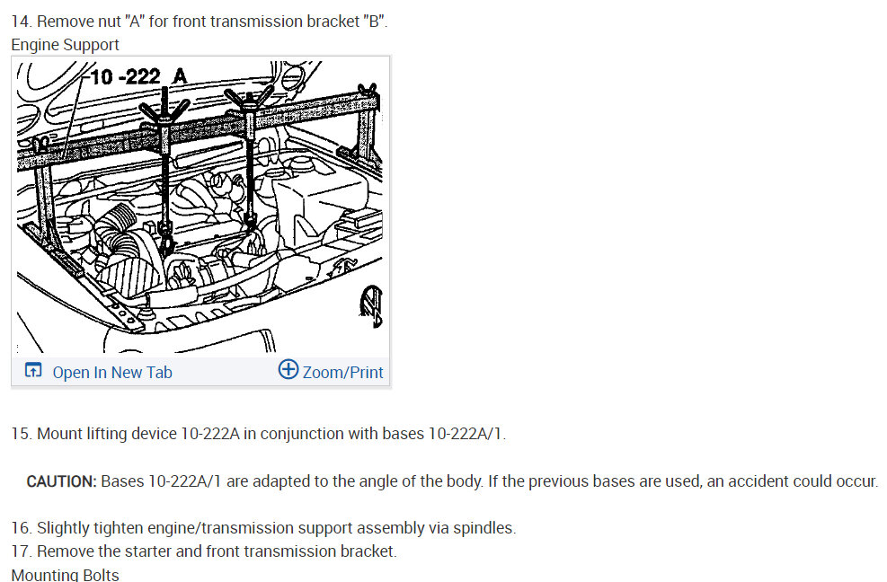

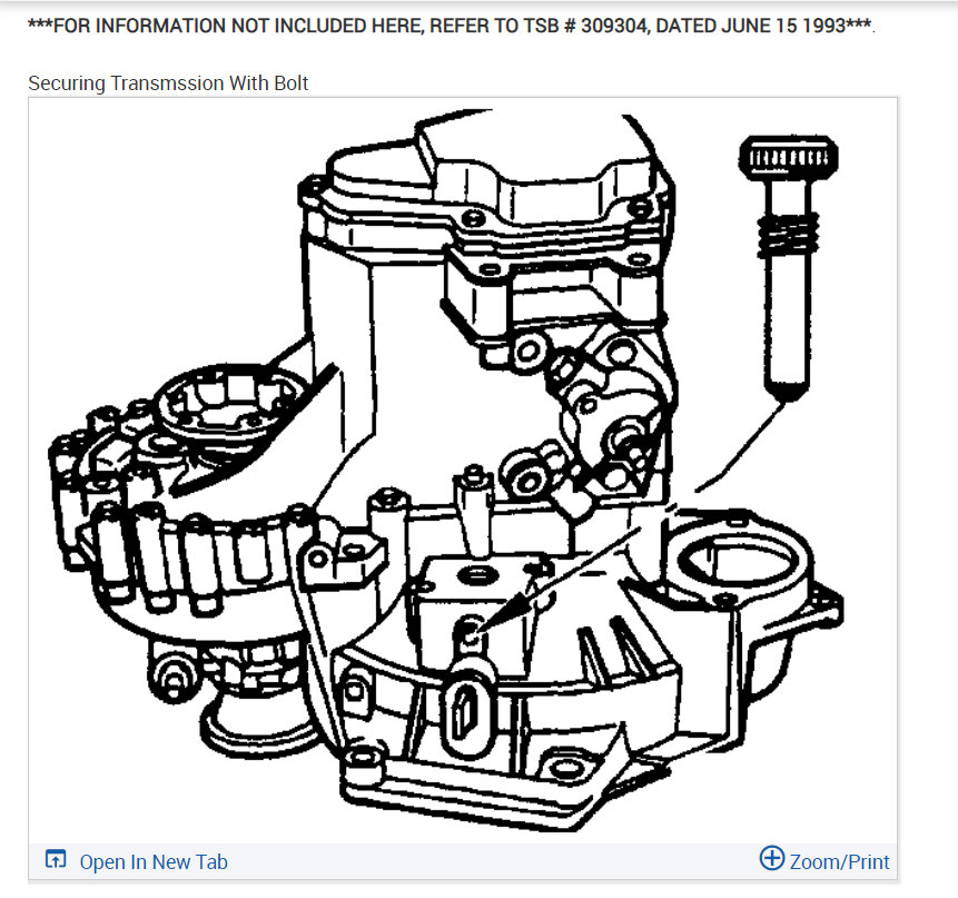

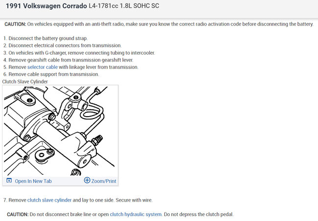

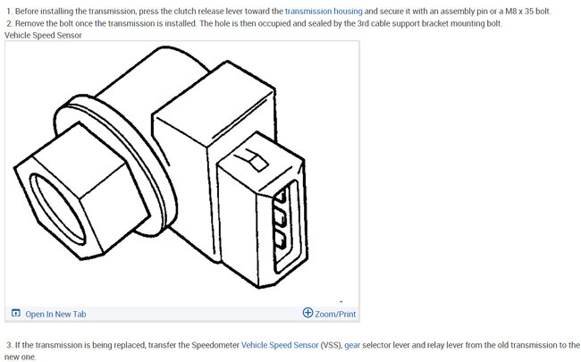

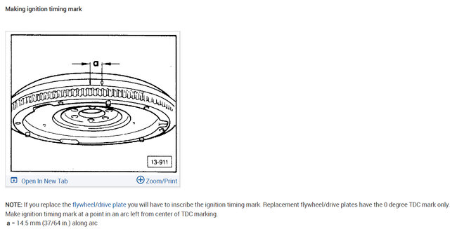

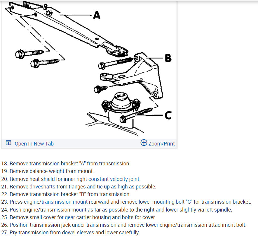

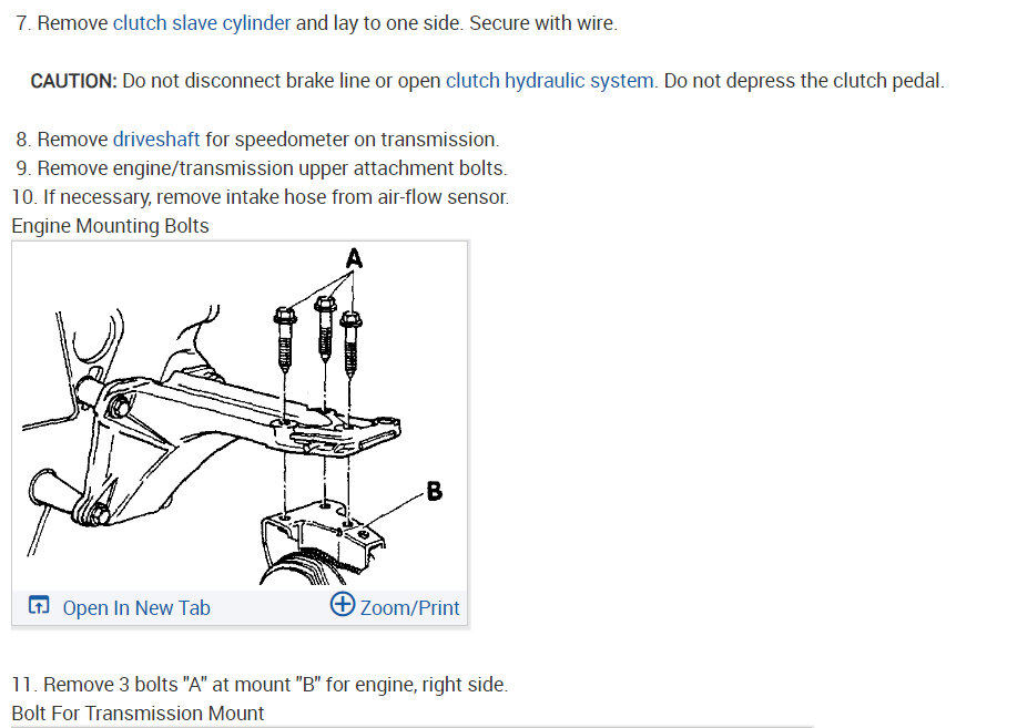

You will need a mechanic's tool set and an engine bay engine hoist. It would be best to use jack stands to hold the car as well. Here is a video of the job being done on a similar car, but the process is the similar and I have included instructions for your car in the images below.
https://youtu.be/6N6b5F2ChyE?si=0XPBv5DnV2DyDLhI
Check out the images (below). Please upload pictures or videos in your response to the problem so we can see what's going on.
