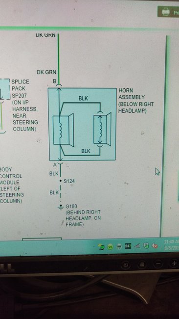

Horn Fuse is good (switched it with a known good one).
Horn Relay is good (switched it with a known good one).
When I press the center of the steering wheel, I can hear the relay click, so assume the switch is good?
Removed horns and tested them separate from the horn system and they both work.
Had the cable harness that plugs into the horn tested and it has twelve Volts output. Connections are clean.
Any idea what else could be wrong that I can try?

So you have twelve volts on the horn connector across the two terminals when pressing the horn button?

Well, if you have power and ground to the horn then a good horn should work. If you only have the power side the horn and not the ground side then there is a problem with the circuit. If you have a ground but no power then you that is a problem. So we need to figure out which one or both we have.

The connector on the cable harness has very small slots, so I inserted stranded wire in the two slots to test it. I have a 12V LED and when I attached it and pushed the horn button it lights up. When I touched the stranded wire to the horn and horn button pressed, it does not honk. I checked the horn again (wires directly from battery) and it works great.

Sounds like a bad ground to me. The LED doesn't require as much current flow to light up as the horn needs to sound.

One test I did was ran the hot (black wire) from the cable harness to the horn, but instead of using the ground (green wire), I connected a separate wire from a screw on the chassis to the horn. Would this have confirmed if the ground was bad?

I previously hooked one end of the LED to positive red terminal on battery and the other end touched the screw and it lit up.

Like I said earlier, an LED doesn't require that much current to light up. A horn requires a good deal more current to honk.

Check out the picture I posted it shows the ground for the horn and it's location.I would say there is probably crossing where the ground is mounted .That would explain the led lights up but the horn doesn't work.
