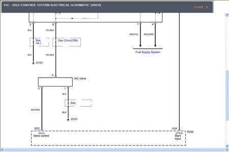

Car is stalling at idle, idle drops to 0 RPM, runs fine with foot on the accelerator.

Hi Impallass I believe the problem is the idle valve or the circuitry to the idle valve.The idle is control by the PCM. make sure the ground BLK wire from the IAC valve is not lose, the YEL/BLK wire from the the PDM- FI relay has voltage, and finally the BLK/RED wire between the PCM and the IAC has also continuity. All computer-controlled system require the use of a digital ohmmeter with at leat 10 megohms impedance or damage to the onbord computer could result you right about the code, because it could be something else. hope it no offense. hope you can see the diagram
https://images.2carpros.com/forum/automotive_pictures/46384_1_2.jpg
