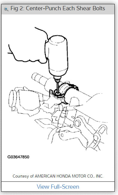

Can you as briefly but thoroughly instruct me on how to replace the Ignition Switch Lock Cylinder on this vehicle. I was able to remove the key finally. I'm convinced that the locking cylinder is shot.
Also, can I fit my actual ignition switch to the new locking assembly, or do I have to buy both, a new switch and locking cylinder? Which of course would mean now I'd have 2 sets of car keys for this vehicle, unless it's possible that a lock smith could change the tumblers in the new lock to match my existing key?
Peace & kindness, Charles
+1
Saturday, May 23rd, 2020 AT 12:08 PM (Merged)
KHLOW2008
  • 41,815 POSTS
Hi chicojazz,

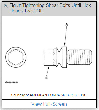

To remove the lock cylinder, you have to drill the shear bolt out and with ignition key in " I " position, press the locking pin with a screwdriver to pull the lock cylinder out.
The ignition switch may be reused.
The tumblers may be rematched to use the original key but is not going to be an easy job.

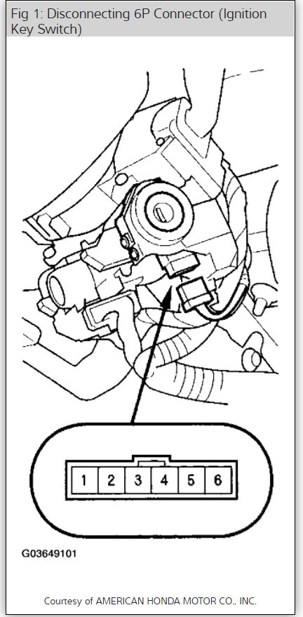

HONDA TECH 1818
  • 536 POSTS
Remove the shift lock cover on the steering column top cover and put a small flat head screwdriver in the hole to release the shifter, shift the gears back and forth and back to park, then try to remove the key from the ignition. If it does work you will need to replace ignition lock here are the instructions and a guide that may help was well
https://www.2carpros.com/articles/ignition-switch-wont-turn-stuck

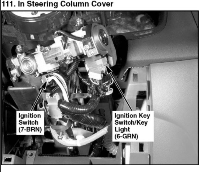

BLUELIGHTNIN6
  • 16,542 POSTS
1. Disconnect and isolate the negative battery cable, then wait at least 3 minutes before proceeding to disable the air bag system.
2. Remove the lower panel of the dashboard.
3. Remove the knee bolster.
4. Remove the steering column covers.
5. Unplug the connectors from the under dash fuse block.
6. Remove the steering column upper and lower covers.
7. Position the ignition switch to the 0 position.
8. Remove the two screws that secure the switch to the mount.
9. Pull the ignition switch away from the mount.
10. Installation is the reverse of the removal procedure.
