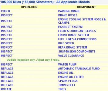

Good idea, BUT- I can't find any info on performing the tune up except changing the spark plugs! I've searched the internet for over an hour and looked in my Chilton's manual. Spark plugs, air filter - that's about it.
Suggestions?
Sunday, March 29th, 2009 AT 9:16 PM
ZACKMAN
  • 4,202 POSTS
While that is true (to some degree), spark plug is the only ignition part to replace. You still should replace your PCV valve, clean the throttle body of carbon build-up, add some fuel injector cleaner into the gas tank, replace the cabin air filter and
https://www.2carpros.com/forum/automotive_pictures/55316_01odesseytuneup_1.jpg
You still need to go to Autozone for the scan for the check engine light.
