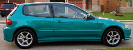

I need to replace the timing belt and maybe the waterpump on my son's '94 Civic DX. He's got over 120k on it and I'm trying to be preventative with the timing belt. I will do the water pump as well if it's not that much more trouble.
http://www.2carpros.com/forum/automotive_pictures/300775_1994hondacivicgreen2_1.jpg
